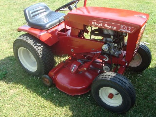

bean 85 #8 Posted August 29, 2013 (edited) if you wanted to get a newer replacement, that somewhat keeps the original look, you could get a Honda gs160 . it is a lighter version of their commercial series Edited August 29, 2013 by bean Share this post Link to post Share on other sites
Luke 9 #9 Posted August 29, 2013 if you wanted to get a newer replacement, that somewhat keeps the original look, you could get a Honda gs160 . it is a lighter version of their commercial seriesuntitled.png I'm afraid the exhaust location of the Honda gs160 would be dangerous to the driver, considering the mounting location on a 1960 Suburban. Share this post Link to post Share on other sites
bean 85 #10 Posted August 29, 2013 (edited) that would be a problem Edited August 29, 2013 by bean Share this post Link to post Share on other sites
