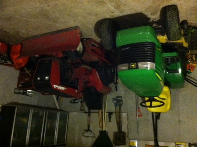

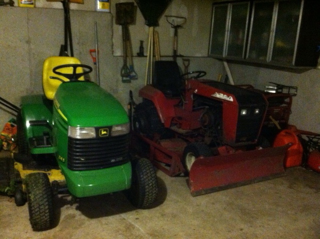

Watch3612 5 #1 Posted August 27, 2013 Hello Red Square! Along with my first post here, this is my first wheel horse, garden tractor restoration and beer-for-tractor trade. I'll stick to the important details: C-175 - KT17 Series I with a broken rod (no holes in the block) along with a really nice 46" deck, plow blade, tire chains and wheel weights for a case of beer and future horseback riding lesson for his son (my wife teaches riding lessons). The motor has serious blow by on the other cylinder, and my fathers yard is hilly, so a rebuild is not a great option. My goals are: 1. Repower and use the original manual PTO; 2. Clean up the body panels and repaint the hood, but not a full restoration; 3. Rewire with safety switches in place (harness was hacked); On to my engine questions: 1. After doing a lot of reading, I'm leaning towards repowering with a Kohler K341 for swap simplicity and longevity, but was looking for feedback if this was the best option? I want to keep it simple as my local parts availability is limited. 2. I am most concerned about the K341 taking the original PTO (diameter and length) and clearances to body panels. I can always offset the motor and change the belt length, but would prefer to keep as much original as possible. Can anyone supply the Kohler K341 Engine Spec(s) that would work or a resource where I can find them myself? 3. Any other advice is appreciated. Looking forward to this winter project! Thanks for your help. 1 Share this post Link to post Share on other sites
Watch3612 5 #2 Posted August 27, 2013 Thats interesting because it shows up just how it should on my iPad. Share this post Link to post Share on other sites
rmaynard 17,582 #3 Posted August 27, 2013 I've seen this phenomena before. Here it is without the suction cups. Share this post Link to post Share on other sites

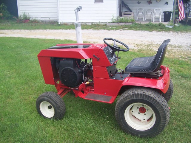

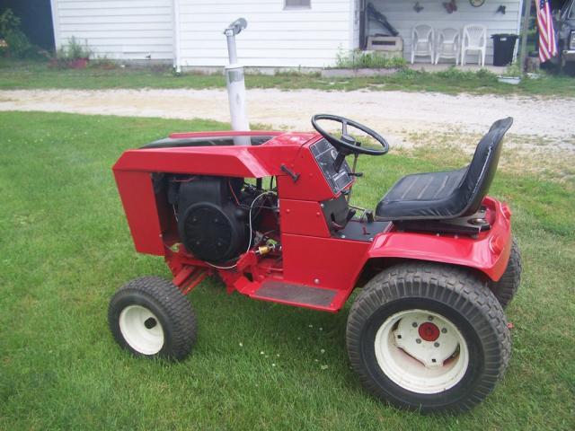

546cowboy 302 #9 Posted August 29, 2013 (edited) Actually I have done two of those conversions to a K-341 in a C-175. You would have to have the shaker plate for a K-341 because the plate for the K-17 does not have the hole in it for the sump in the 341 pan. Of course you could cut a hole in the shaker plate you have but I don't know if the mounting hole for the engine will line up. Another thing you have to do is move the shaker plate mounting blocks ( there is another set of holes already in the frame ) or the engine will be too far forward as I recall. Everything will line up then on the PTO. You would also have to change the choke and throttle cables because they are too short to reach the front of the K-341. It makes a fine tractor though when you are done. The K-341 has plenty of power. Here is a picture of the last one I did. Edited August 29, 2013 by 546cowboy 1 Share this post Link to post Share on other sites

546cowboy 302 #11 Posted August 31, 2013 I just couldn't tell what that engine came out of but if you are looking at a K-341 on-line and it says it is a K-341A or AS then it has the pan that has a bump-out. Like I said though I was lucky to have that shaker plate I needed. Another reason that not much gets thrown away around here. HA! Share this post Link to post Share on other sites
