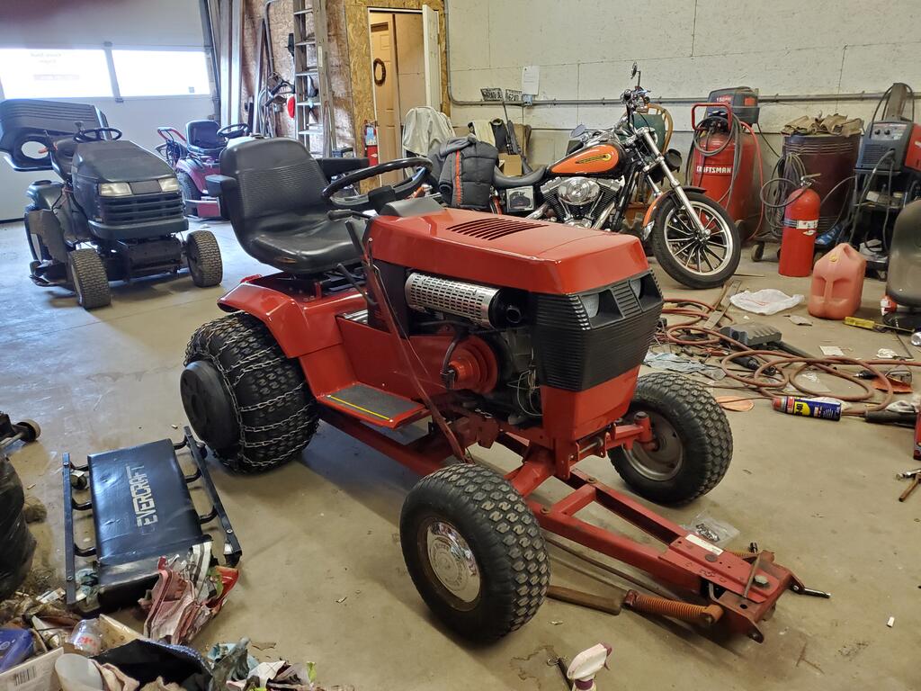

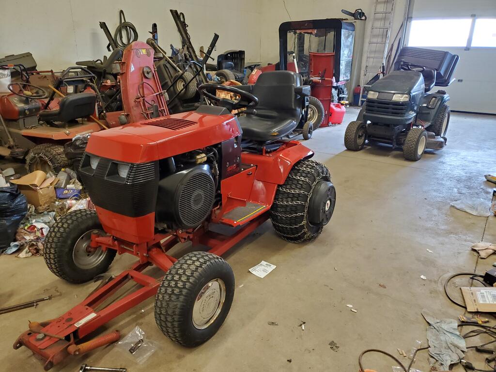

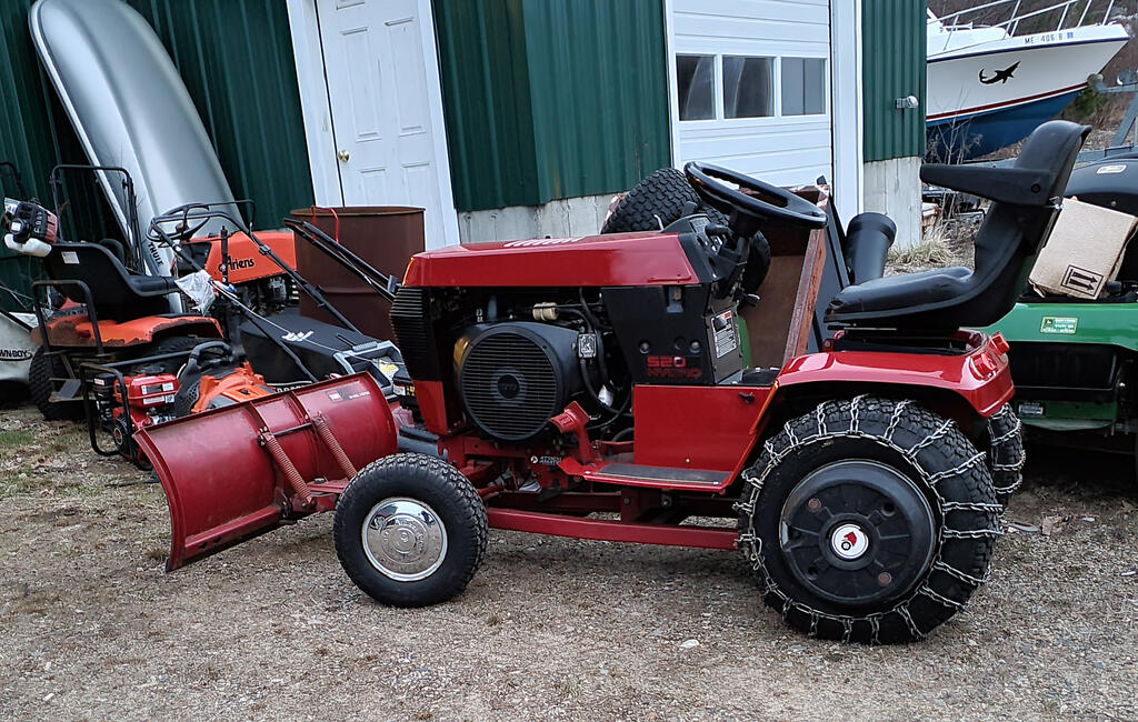

Kevin Bowley 140 #22 Posted April 9, 2022 (edited) Here is my '95 520-H, which strangely used the old candy red rather than the "new red", painted with Rustoleum IH red. I'm VERY happy with the results. The new decals from Terry will be here Monday. I never expected to get such an excellent gloss nor a sort of "candy" look from a rattle can. It looks better in person. Also, note how close the color match is to the unpainted chassis parts. Almost an exact match Edited April 9, 2022 by kbowley 2 Share this post Link to post Share on other sites

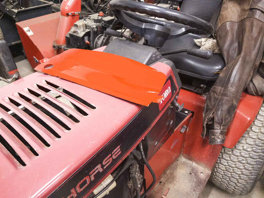

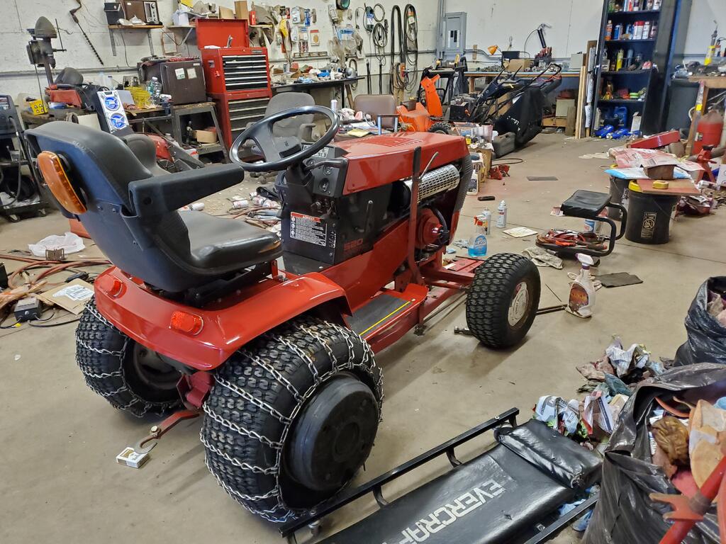

Kevin Bowley 140 #23 Posted April 9, 2022 (edited) This is what it looked like when I started...Note the test piece of metal on the hood. that was painted with the "Toro New Red" and it is not even close to matching...it has to much yellow/orange in it compared to the original paint. Edited April 9, 2022 by kbowley Share this post Link to post Share on other sites
