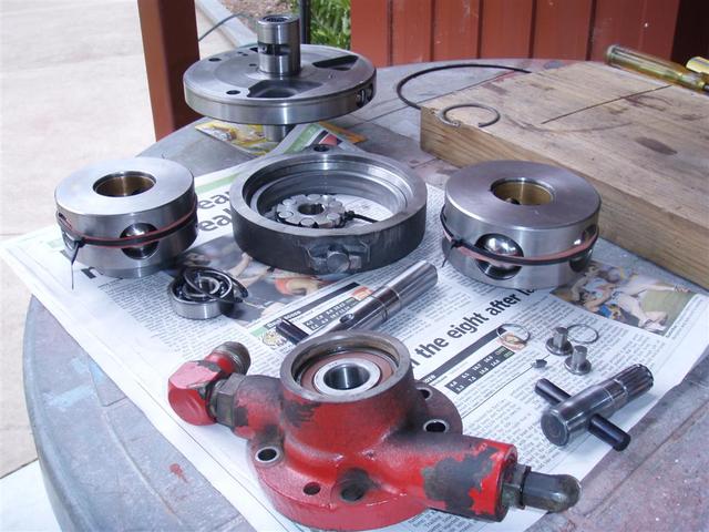

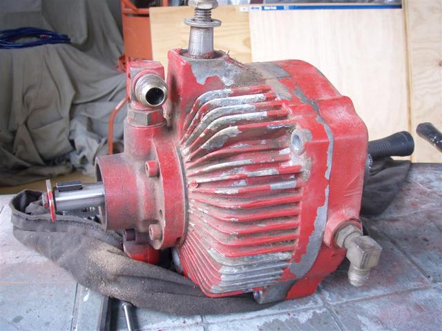

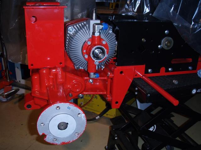

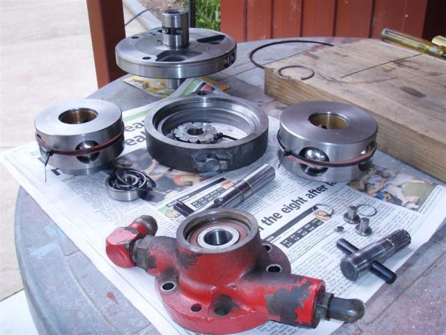

Aussie 98 #12 Posted September 10, 2013 I have recently rebuilt the hydro unit in one of my 520H tractors, but haven't tried it out yet as the tractor has some way to go before it is finished. The seal kit is available p.n. 563310 and priced at $40.11 from Jack's where I get all my parts. Input and output shaft bearings are commonly available from bearing suppliers. I pulled mine down and cleaned everything then reassembled with new seals and replaced input shaft bearing. The output bearing was fine as it is constantly flooded with oil being the return path for oil from the hydro to trans. The input bearing is sealed so I replaced that as a precaution. Things to look for are wear and scoring in the pump and rotor balls and races and these can be fairly terminal or expensive to replace. Other than that it is vital to keep the balls in their correct pockets and obviously cleanliness is essential. My hydro was in good condition without apparent issues so I reassembled everything. I took a heap of photos but not a step by step record. The manual is easy to follow. The main reason I pulled mine apart was I was worried about corrosion of the cooling fins so I got the housing blasted. 6 3 Share this post Link to post Share on other sites
pfrederi 17,147 #13 Posted September 10, 2013 Great info and pictures...Thank You!! 1 Share this post Link to post Share on other sites
