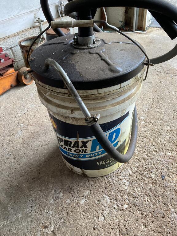

slim67 2,825 #7 Posted December 12, 2020 I got this out of an elderly neighbors trash. He passed away and his wife has been getting rid of stuff. The pump works and it’s still half full. I will use it for my 654. Share this post Link to post Share on other sites
