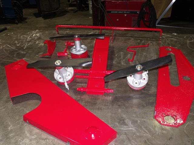

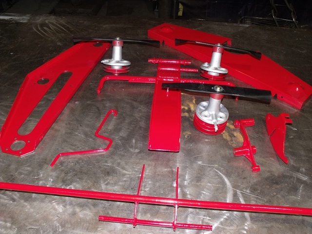

Sycoticca 37 #1 Posted August 22, 2013 (edited) Deck pieces blasted and painted and spindles rebuilt . Now to start the deck there are 3 spots that need to be cut out and replaced The PO had patched over top that will not do... Need to get new wheels and rollers. Edited August 22, 2013 by Sycoticca Share this post Link to post Share on other sites
