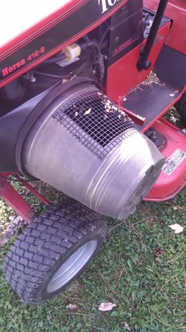

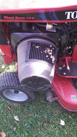

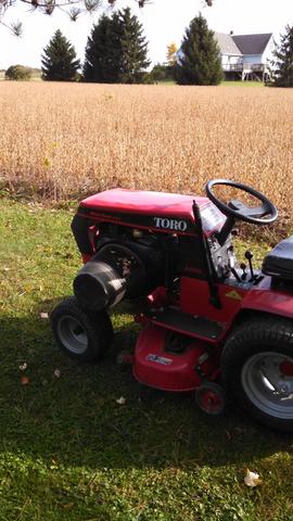

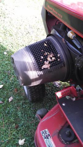

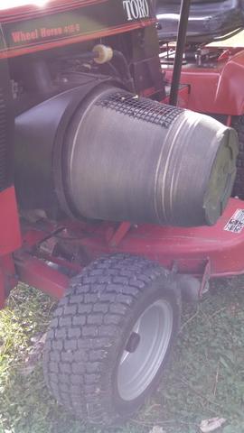

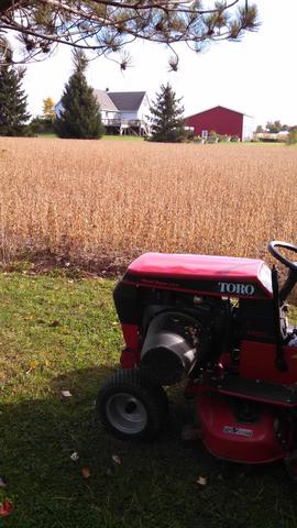

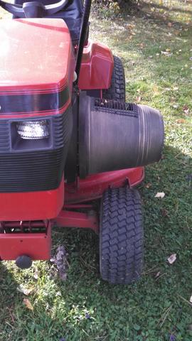

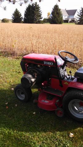

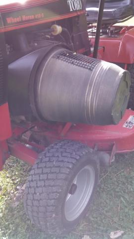

Dave H. 15 #33 Posted October 11, 2014 For those of you on a budget and need a quick fix for mulching, this flower pot + 4 self tapping screws with a bit of chicken wire does the trick. The pot is 13 inches in diameter and fits like a glove. Just some old stuff laying around in the barn. I know, it's pretty simple. But after two days of mulching, it's worked like a charm. No problems yet and the cooling is fine. Have a great weekend everyone! Share this post Link to post Share on other sites
boovuc 1,090 #34 Posted October 12, 2014 I like that Dave but knowing how large the air intake is, (about 10 inches in diameter), on the flywheel screen on the Onan verses the cone you have on your 520, I question if you really do have adequate air. Granted that in the Fall, the air temperatures are lower than in the Summer but I would still be concerned about not driving enough air through that motor and in particular, the rear cylinder. I'm working on a 10 inch blank flange mounted to a 12 inch elbow of simple galvanized heat duct. It's lightweight and with a little trimming and a few rolls to curve out the flange, I hope to have it mounted to my 416 this week. The 10 inch blank flange has a large lip that should catch the 5 mounting holes in the Onan's tin. The 12 inch elbow would be epoxied to the OEM Onan fly wheel screen. (I have a spare). The elbow would be positioned straight up. We shall see. If not, I wasted about 35 dollars at McMaster-Carr. Should have the parts this week. Share this post Link to post Share on other sites
Dave H. 15 #35 Posted October 12, 2014 I like that Dave but knowing how large the air intake is, (about 10 inches in diameter), on the flywheel screen on the Onan verses the cone you have on your 520, I question if you really do have adequate air. Granted that in the Fall, the air temperatures are lower than in the Summer but I would still be concerned about not driving enough air through that motor and in particular, the rear cylinder. I'm working on a 10 inch blank flange mounted to a 12 inch elbow of simple galvanized heat duct. It's lightweight and with a little trimming and a few rolls to curve out the flange, I hope to have it mounted to my 416 this week. The 10 inch blank flange has a large lip that should catch the 5 mounting holes in the Onan's tin. The 12 inch elbow would be epoxied to the OEM Onan fly wheel screen. (I have a spare). The elbow would be positioned straight up. We shall see. If not, I wasted about 35 dollars at McMaster-Carr. Should have the parts this week. Good Day boovuc, You bring up a good point, later today I'll cut a hole in the end of it to increase the air intake area. I hope you'll post a pic of the system your working on. I'd like to build something a bit more stable then this temp fix I have now. Thanks for the advice and have a great weekend. Share this post Link to post Share on other sites
boovuc 1,090 #36 Posted October 12, 2014 If it works, I'll post some pics. If it doesn't, I've already proclaimed wasting over 40 bucks with shipping for the pieces plus I would have cut my spare engine's flywheel screen? I'll just crawl under a rock for awhile! Share this post Link to post Share on other sites

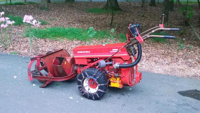

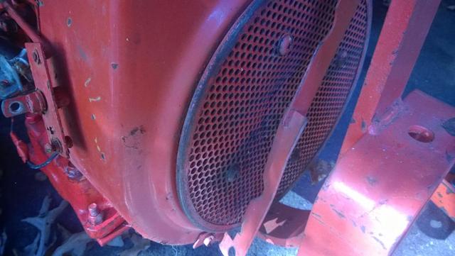

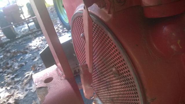

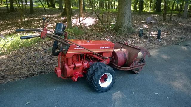

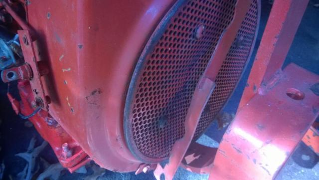

shallowwatersailor 3,216 #37 Posted October 12, 2014 (edited) I don't use my two 520-H for mowing but I can see the need for correcting the problem . An advantage of having other manufacturer's tractors is to be able to see how they handled similar issues. Attached are two pictures of my 1980 Gravely 5665 with a Kohler K301 shortly after I bought it. Gravely made two changes that might be of interest. This model was intended for commercial use and so has a remote filter. It is away from the working parts of the tractor so the dust issue is lessened. It even has a "reservoir" to be emptied as needed for larger particles . The second addition on electric start Kohlers was a scraper to address grass/debris buildup on the flywheel screen. It has two edges that are angled towards the screen to knock buildup off. I can be seen just in front of the hitch. It has about 3/8" clearance. Edited October 12, 2014 by shallowwatersailor 1 Share this post Link to post Share on other sites
Dave H. 15 #38 Posted October 12, 2014 If it works, I'll post some pics. If it doesn't, I've already proclaimed wasting over 40 bucks with shipping for the pieces plus I would have cut my spare engine's flywheel screen? I'll just crawl under a rock for awhile! Sounds like you know what you're talking about. That suggestion you made about the air intake diameter may have saved my engine. (And a royal a** chewing from my better half when I tell her I blew the engine up ) After looking at the pictures I posted, it makes me think of that old saying; "You might be a Red Neck if................?" But any old port in a storm. Right? I hope you'll keep working on the idea you have and share the pics. This debris ~Mulching~ problem is a REAL PAIN! After 4 hours of mulching and every 5 minutes cleaning that damn intake, I would have used an old shoe box if I thought it would work. Again, thanks for the advice. Share this post Link to post Share on other sites
Dave H. 15 #39 Posted October 12, 2014 I don't use my two 520-H for mowing but I can see the need for correcting the problem . An advantage of having other manufacturer's tractors is to be able to see how they handled similar issues. Attached are two pictures of my 1980 Gravely 5665 with a Kohler K301 shortly after I bought it. Gravely made two changes that might be of interest. This model was intended for commercial use and so has a remote filter. It is away from the working parts of the tractor so the dust issue is lessened. It even has a "reservoir" to be emptied as needed for larger particles . The second addition on electric start Kohlers was a scraper to address grass/debris buildup on the flywheel screen. It has two edges that are angled towards the screen to knock buildup off. I can be seen just in front of the hitch. It has about 3/8" clearance. WP_20140811_016.jpgWP_20140815_003.jpg John, I see the bar that sits in front of the air intake. Is that what you're refering to? If so, would that work on a side intake system with fine mulched material. Share this post Link to post Share on other sites
shallowwatersailor 3,216 #40 Posted October 12, 2014 (edited) Here are two better shots of the scraper. Notice how the left side has cutouts for the bolts. Gravely ride-on owners have the same problem because the tractor has the engine in the rear. Some of the Kohler-engined riders didn't use the bar but had a bolt-on screen that plugged up. Some ride-ons used Onan engines as well although a different model Onan. The screen on the Kohler rotates so for the Onan a screen that would be attached to the flywheel would be needed. The plastic guard would be discarded. Edited October 12, 2014 by shallowwatersailor Share this post Link to post Share on other sites
shallowwatersailor 3,216 #41 Posted October 12, 2014 Good Day boovuc, You bring up a good point, later today I'll cut a hole in the end of it to increase the air intake area. I hope you'll post a pic of the system your working on. I'd like to build something a bit more stable then this temp fix I have now. Thanks for the advice and have a great weekend. Dave, I wouldn't cut any opening on the vertical end. You would be back where you started. Cut some more of the lower portion below the lip on the side, if anything. John Share this post Link to post Share on other sites
Dave H. 15 #42 Posted October 12, 2014 (edited) I see it now John. I can understand that it would be handy for snow build up. Not so sure about finely minced leaves plugging the intake. Those particles are so small they just stick to every inlet available. Thanks for taking the time to snap these pictures. Somewhere down the road, someone will take a look at these and have a brainstorm idea. I hope you have a good weekend. Best Regards, Dave John, I just received your last post, I'll take a look at cutting that hole a bit wider. Thanks. Edited October 12, 2014 by Dave H. Share this post Link to post Share on other sites
shallowwatersailor 3,216 #43 Posted October 12, 2014 I think that the scraper depends on some buildup, and then takes the "sheet" off. Share this post Link to post Share on other sites
