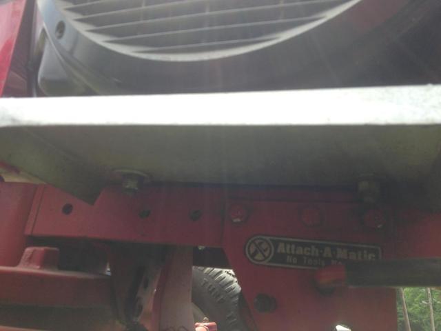

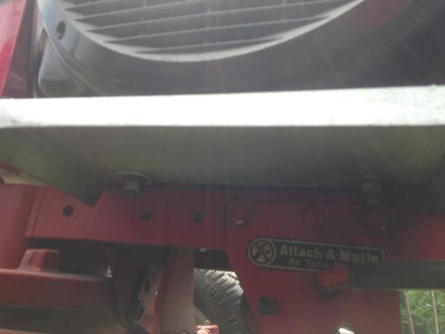

Brian K WheelHorse 28 #1 Posted August 14, 2013 (edited) After a lot of discussion, I really thought I needed to come up with something to keep the darn grass, leaves and debris off the intake screen of my 520H. Well - it took me 3 tries to get one (the first one was a frame mounted steel version) to fit and I had some time to install it and test it tonight. It looks a bit...weird. I used polycarbonate and some aluminum angle to construct it. Almost all the screws are stainless steel. Some things to keep in mind: I did have to remove the lip from bottom of the intake screen. I shimmed this out from the inside screen with 1/4 - 20 flat washers to clear the heads of the button head screws that rotate on the inside screen. It still rubbed a little bit but not enough to bother me - it "cleared out" a little material off the polycarbonate. If I held my dimensions tighter this would have been a non-issue. The angles help it clear the front wheel (turned all the way) and the foot rest. Seems to work OK but it needs to be used for a few weeks to test the durability of it. Here's some pics: Prototype 2 - FAIL: Prototype 3: That's all the grass after mowing for more than 30 minutes. I was purposely mowing over old grass piles to kick up a lot of clippings - seems to work well. Notice there isn't any grass on the screen below the shield. Edited August 14, 2013 by Brian K WheelHorse 3 Share this post Link to post Share on other sites
Red-Bovine 337 #3 Posted August 14, 2013 Excellent!!! I need to design something similar for my 520Honda. Red Share this post Link to post Share on other sites
Brian K WheelHorse 28 #4 Posted August 14, 2013 It just mounts with the 2 bottom screws for the screen... Share this post Link to post Share on other sites

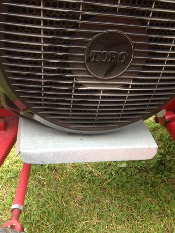

leeave96 496 #5 Posted August 14, 2013 Here is a couple of pics grass shield used/made by a fellow at the Wheelhorse show this past June. He fab'd and had installed it on his fine 520H tractor. I hope it's OK that I post the pics here as the design is simple and according to the gentleman I spoke with - worked great. I haven't had a chance to fab one of these for my 520H, but would like to and give it a try. Note the slickery Toro logo on the Onan grass screen.... Thanks! Bill 1 Share this post Link to post Share on other sites
Red-Bovine 337 #6 Posted August 14, 2013 I guess all you need is something to deflect the airflow to the motor so it doesn't suck the grass of the deck. I've been meaning to fabricate something and this thread has inspired me. Thanks, guys!!! Red 1 Share this post Link to post Share on other sites
leeave96 496 #7 Posted August 14, 2013 I guess all you need is something to deflect the airflow to the motor so it doesn't suck the grass of the deck. I've been meaning to fabricate something and this thread has inspired me. Thanks, guys!!! Red Sometimes I think the grass that is getting sucked into the flywheel screen is from two sources. One is the grass being blown out the left front of the deck. The other is simply grass that sticks to the front wheel and is kicked off as the wheel turns. Both of these sources of grass tend to float in the air just at the lower part of the flywheel screen and the Onan sucks it right in. Share this post Link to post Share on other sites

leeave96 496 #15 Posted August 15, 2013 I'm a fairly pragmatic person...to a point. I have owned this tractor for only one year and I have looked down and saw the red overtemp light on, four separate times. I am fairly deliberate about checking for grass buildup, but it has happened more than once so for me - it needed to be addressed. This is a design flaw, period. I have literally mowed 1/2 an acre and my screen has been completely packed. I really didn't post this for a debate. I really would have rather not invest the time, but for me - it was necessary. I sold my 314-8 when I got this one so I don't currently have a back-up mower if I wreck this one. I have already installed a sounder alarm as well but I haven't wired it up. I wanted first to prevent the buildup. I de-carboned and installed new gaskets on my engine last year so I don't think this overkill. Let me say this - I have a large back yard and we don't use most of it but I keep it clear. I only mow back there once a week. I typically get some small "hay piles" so I have quite a bit of clippings blowing around when I mow. Because of the rain I haven't touched the back for 10 days now - and it is a little high. Now if you are in the "yard-of-the-month club" and mow every few days - this may not even apply to you. This is a great topic. I was at a yard sale a few weeks ago and saw a 416-8 with an Onan on it parked under a deck. The flywheel screen was packed with clippings. I'm lining up Winter projects (since I'm wearing a long sleeve shirt here in mid August in my neck of the woods) and I think I'm going to add belting to the front of the deck to bring the front lip down even with the sides, like my rear discharge decks and my MTD Cub Cadet deck - none of which throw grass out the front of the deck. I'd also like to make a sheet metal shield mounted to the underside of the flywheel screen like the picture I posted earlier in this thread. I know sometimes it seems like when we talk about this grass build-up on the Onans, it seems like we are beating a dead horse (no pun intended... ), but I suspect that every day or week a new owner of these tractors comes online, so it's great conversation and good to keep this issue on the front burner for the new comers IMHO. Thanks! Bill 1 Share this post Link to post Share on other sites
Red-Bovine 337 #16 Posted August 15, 2013 I think this is a great idea, too!!! As long as you don't impede the airflow into that screen by reducing the number of square inches the motor has to grab the air, it should not harm the motor. I like the idea of the deflector mounted below the motor and you still have good access to the screen should anything still get by. A person gets pretty tired of swiping grass off that screen, especially when you have a lot of grass to cut and you may be swiping every 5 or 10 minutes. Don't forget you have to slow the motor, stop, disengage the pto, swipe the grass off, throttle up, re-engage the pto and start mowing again. My arms aren't long enough to reach the screen and not trip the safety switches. Sure seems to be a better idea than letting the screen get plugged up and the temps bounce around. Not to mention what crap gets by the screen and lodges itself in the motor. Best to try to minimize the clippings and not minimize a persons efforts. Red 1 Share this post Link to post Share on other sites
Brian K WheelHorse 28 #17 Posted August 15, 2013 I'm a fairly pragmatic person...to a point. I have owned this tractor for only one year and I have looked down and saw the red overtemp light on, four separate times. I am fairly deliberate about checking for grass buildup, but it has happened more than once so for me - it needed to be addressed. This is a design flaw, period. I have literally mowed 1/2 an acre and my screen has been completely packed. I really didn't post this for a debate. I really would have rather not invest the time, but for me - it was necessary. I sold my 314-8 when I got this one so I don't currently have a back-up mower if I wreck this one. I have already installed a sounder alarm as well but I haven't wired it up. I wanted first to prevent the buildup. I de-carboned and installed new gaskets on my engine last year so I don't think this overkill. Let me say this - I have a large back yard and we don't use most of it but I keep it clear. I only mow back there once a week. I typically get some small "hay piles" so I have quite a bit of clippings blowing around when I mow. Because of the rain I haven't touched the back for 10 days now - and it is a little high. Now if you are in the "yard-of-the-month club" and mow every few days - this may not even apply to you. This is a great topic. I was at a yard sale a few weeks ago and saw a 416-8 with an Onan on it parked under a deck. The flywheel screen was packed with clippings. I'm lining up Winter projects (since I'm wearing a long sleeve shirt here in mid August in my neck of the woods) and I think I'm going to add belting to the front of the deck to bring the front lip down even with the sides, like my rear discharge decks and my MTD Cub Cadet deck - none of which throw grass out the front of the deck. I'd also like to make a sheet metal shield mounted to the underside of the flywheel screen like the picture I posted earlier in this thread. I know sometimes it seems like when we talk about this grass build-up on the Onans, it seems like we are beating a dead horse (no pun intended... ), but I suspect that every day or week a new owner of these tractors comes online, so it's great conversation and good to keep this issue on the front burner for the new comers IMHO. Thanks! Bill I wanted to make it out of 18 or 20 gauge steel, but I don't have access to a brake and shear right now. I think that's a great idea. Share this post Link to post Share on other sites

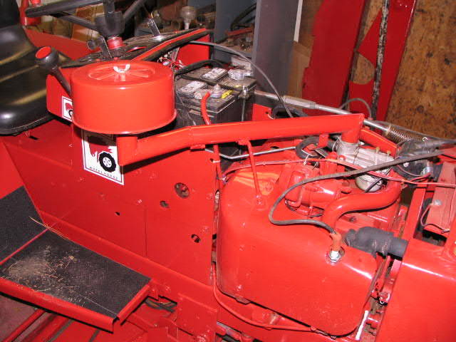

pacer 3,181 #24 Posted August 17, 2013 Snorkel air intakes and problems with chaff on the shrouds reminded me of a similar problem I had, only in a different area. My D-180 would not get a hint of debris on the shroud but would suck gobs into the air filter as it was mounted on the motor in its factory position. I would have to blow it off after every mowing - especially later into the summer when the grass tended to get drier. After some deliberation - and poking around in the scrap metal box, I came up with this solution. A piece of 1 1/2" exhaust pipe welded up to remote the air filter out from under the hood, it works GREAT. I can go a couple seasons without the filter showing any sign of collecting chaff. 1 Share this post Link to post Share on other sites
Brian K WheelHorse 28 #25 Posted August 17, 2013 Snorkel air intakes and problems with chaff on the shrouds reminded me of a similar problem I had, only in a different area. My D-180 would not get a hint of debris on the shroud but would suck gobs into the air filter as it was mounted on the motor in its factory position. I would have to blow it off after every mowing - especially later into the summer when the grass tended to get drier. After some deliberation - and poking around in the scrap metal box, I came up with this solution. A piece of 1 1/2" exhaust pipe welded up to remote the air filter out from under the hood, it works GREAT. I can go a couple seasons without the filter showing any sign of collecting chaff. Wow - that's a cool setup! Share this post Link to post Share on other sites
