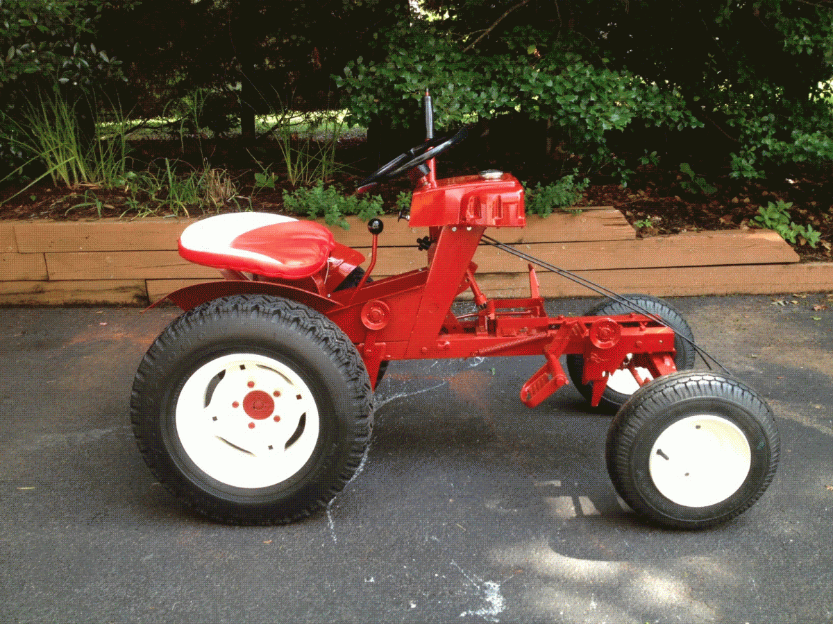

WheelHorse79 271 #5 Posted August 6, 2013 (edited) Here is a picture of my restoration to this point. The engine is now on the tractor. Could someone please post a picture or diagram that shows the routing of the throttle cable, choke cable and fuel line? Thanks! Edited August 6, 2013 by WheelHorse79 Share this post Link to post Share on other sites
buckrancher 2,697 #6 Posted August 6, 2013 (edited) Choke cable shoud run down and between blower housing and block and up to choke Edited August 6, 2013 by buckrancher Share this post Link to post Share on other sites
WheelHorse79 271 #8 Posted August 7, 2013 Thanks for the pictures. My 854 wasn't using the fuel pump and was direct gravity feed into the carb. Is it worth trying to run the fuel line thru the pump? Mine may not be working. Also, my throttle cable was run directly to the throttle plate and not to the governor like yours. I'll have to try your setup. The choke cable looks to be straight forward. I'll give that a try too. Obviously, someone has monkeyed with this engine in the past. Share this post Link to post Share on other sites
buckrancher 2,697 #9 Posted August 7, 2013 you had better fix the throttle cable thru the governor if you don't want your motor in pieces and your going to want the fuel pump if you have hills as you can run out of gas goung up one when the tank is low Brian Share this post Link to post Share on other sites
