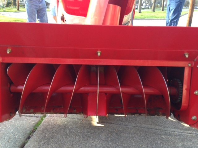

RMCIII 840 #1 Posted August 4, 2013 Venting.... Man, I thought Deere was expensive when I owned 1 one....Toro/Wheel Horse must have captured that market for sure. Let's take a look at the costs: 2 self aligning bearings - new $49.95/each 1 primary shaft because old one is worn slightly so I don't want to keep doing the bearing thing - $300.00 1 technician $65/hr for 2 hrs. to help with the project. $130.00/hr < not that big a deal since he is a friend Total $530.00. WTH!!!! I could have bought a used one for half as much and had one to use for extra parts. Mine is almost new in condition so I really did not want to scrap it, but MAN!!!! This is ridiculus. Not to mention I just put a new PTO mower belt on. $79.95/ plus tax. $82.50... Not complaining, well yes I am.... My Deere was actually cheaper the maintain than this one. Share this post Link to post Share on other sites

Jeff-C175 7,211 #5 Posted August 5, 2013 Looking at the condition that blower appears to be in I'm really surprised that it needs ANY work at all, let alone new bearings and a shaft! Share this post Link to post Share on other sites

doc724 927 #7 Posted August 7, 2013 I have a 42 inch blower (its a 98 model) on my 5xi. It looks in about the same condition as yours. I did replace the main bearings, not because they were bad, but more as preventive maintenance (as this is my only method of snow removal). I was also told by a WH dealer that the problem with most blowers is that people tighten the chains too much which results in chain wear and more importantly sprocket wear. The sprocket is welded to the auger and replacing it I guess is not so easy. P.S. make sure you put some good lube on the chain. I have been using chain saw bar oil as it is thick and will not get thrown off (too much). Seems to works OK, but maybe there is a better alternative Share this post Link to post Share on other sites

RMCIII 840 #9 Posted August 8, 2013 (edited) Red- well, I am glad one of us got a deal. Looks truly amazing. Doc- agree. It would seem that the sprocket could cause some unnecessary wear if the chain was over tightened. I guess that is the reason why some of the cost is so much for that shaft. It includes the sprocket. Thanks everyone else also Edited August 8, 2013 by RMCIII Share this post Link to post Share on other sites
