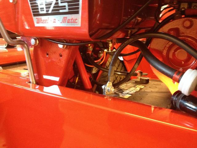

woodbird007 16 #6 Posted October 14, 2013 I was planning on changing to Solenoid starting circuit for my 875, but am unsure where to mount it. Pretty tight on those short frames between battery and starter. Ideas? Share this post Link to post Share on other sites
Martin 2,134 #7 Posted October 14, 2013 (edited) Mount it behind the hood stand.use longer bolts through the lift lever cast bracket. There is a thread or two of mine on here with pics of one mounted. Edited October 14, 2013 by Martin 1 Share this post Link to post Share on other sites
