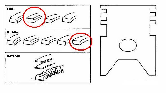

rmaynard 17,642 #2 Posted July 30, 2013 Who did the rebuild? Were the rings installed correctly? That's just one thing that comes to mind when oil is burning after a rebuild. Share this post Link to post Share on other sites

rmaynard 17,642 #4 Posted July 31, 2013 The K301 has three rings. Bottom is the oil ring and generally doesn't get put in wrong because most of them can be installed either side up. The middle ring and top ring are usually the culprits. Each ring has a unique cut on one edge and has to be installed with the cut in the correct position. Each set of rings comes with a diagram of how the rings are to be installed. Generally it appears like this: The above picture represents how my rings appeared on my K301. Share this post Link to post Share on other sites
