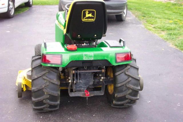

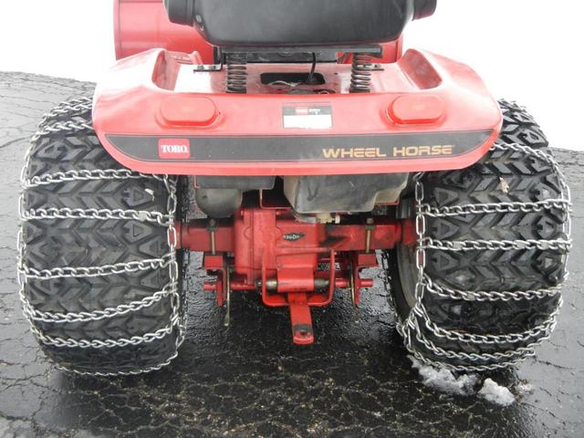

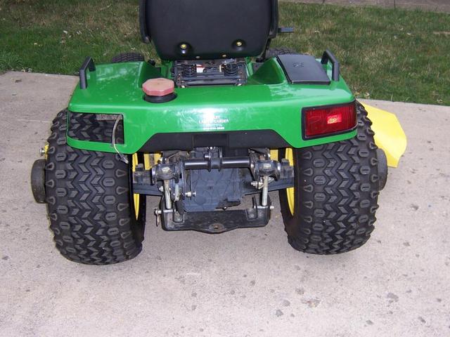

wh5208speed 677 #12 Posted July 30, 2013 I really like the Carlisle All Trail. They are the hybrid between Ag and Turf. They do a great job in the snow. I have a 26-12-12 set on my JD 455 and I have a 23x10.50-12 with Chains I use on my Wheel Horse. I have a steep 400 ft black top driveway and sometimes I can get away with no chains.....some times I can't. I have tried every combination of Ag, turf, weights, chains....and this is the best combination for my application. I would imagine if you were not on concrete or blacktop....or if you driveway is relatively flat......chains would not be as necessary. If you go with Ag.....Firestone 23 degree are the best.....and there shouldn't even be a debate on that one Thad (Ohio) I am including photos Wheel Horse - Carlisle All Trail II 23x10.50-12 with 2 Link Chains JD 455 Carlisle - Carlisle HD Field Trax 26-12-12 JD 455 Firestone - 23 degree Ag 26x12-12 The All Trail II & Field Trax are almost identical. Share this post Link to post Share on other sites

3609horse 27 #20 Posted August 1, 2013 I really like the Carlisle All Trail. They are the hybrid between Ag and Turf. They do a great job in the snow. I have a 26-12-12 set on my JD 455 and I have a 23x10.50-12 with Chains I use on my Wheel Horse. I have a steep 400 ft black top driveway and sometimes I can get away with no chains.....some times I can't. I have tried every combination of Ag, turf, weights, chains....and this is the best combination for my application. I would imagine if you were not on concrete or blacktop....or if you driveway is relatively flat......chains would not be as necessary. If you go with Ag.....Firestone 23 degree are the best.....and there shouldn't even be a debate on that one Thad (Ohio) I am including photos Wheel Horse - Carlisle All Trail II 23x10.50-12 with 2 Link Chains JD 455 Carlisle - Carlisle HD Field Trax 26-12-12 JD 455 Firestone - 23 degree Ag 26x12-12 The All Trail II & Field Trax are almost identical. I ran a set of these this past winter, plowed great, even with the 54" plow they did great. Share this post Link to post Share on other sites
