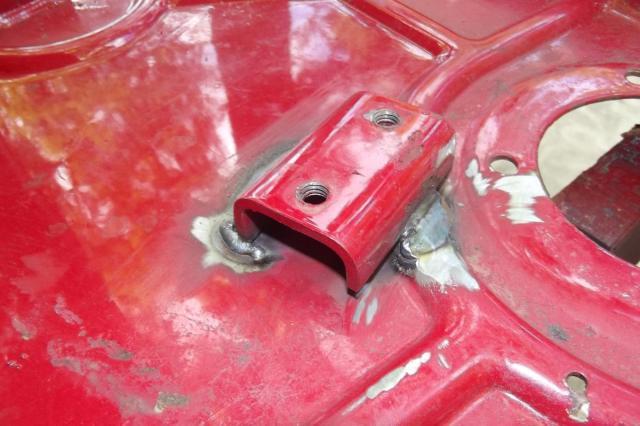

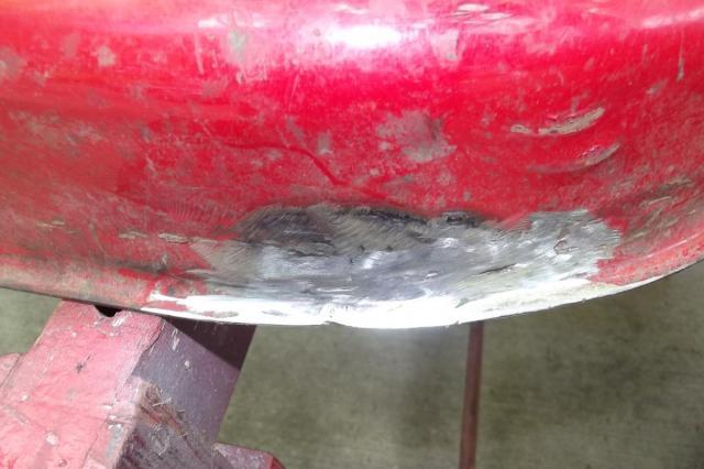

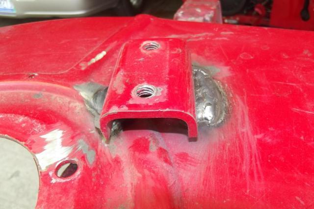

BOWTIE 226 #1 Posted July 25, 2013 My 97 312-8 tractor is done. Now I'm working on my mower deck. PO hit a stump and sliced the deck and broke a weld. Trying to post pictures and they keep failing? 848 kb picture Bowtie Share this post Link to post Share on other sites

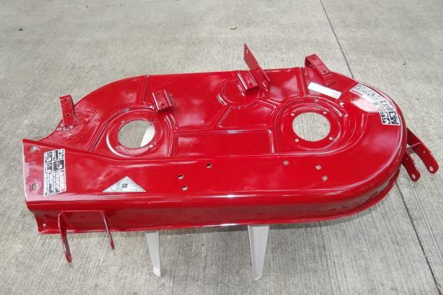

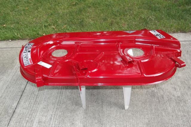

BOWTIE 226 #6 Posted August 7, 2013 I finished the deck up today. It turn out pretty good, will install tomorrow with pictures of the finished tractor. BOWTIE Share this post Link to post Share on other sites
Tankman 3,515 #7 Posted August 7, 2013 Looks very good! Anticipation, let's see the mounted deck on that Horse! Welding light weight sheetmetal, I like to clamp a block of copper or brass behind the area before welding. Stops blow by and makes the weld look great. 1 Share this post Link to post Share on other sites
AMC RULES 36,954 #8 Posted August 7, 2013 Deck looks great... did becoming a supporter last night help with the problems you were having when trying to post picts? Share this post Link to post Share on other sites
