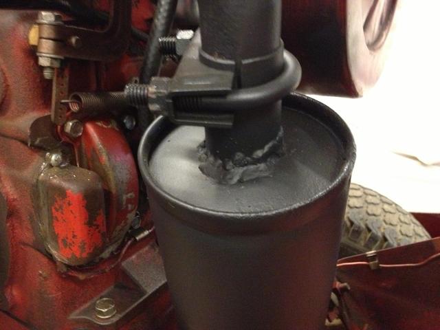

Martin 2,134 #7 Posted July 21, 2013 Any Idea on what would be a suitable fix then for the Nelson? What if I just cut it apart and replace or reweld the internal baffles that are now rattling around. Its a shame to replace a muffler that is perfect on the outside but clapped out on the inside and rattling a lot. I see Parts Tree claims to have a replacement nelson but for $180 to me its not an option. I despise pepper pots and that type of smallmuffler and don't think I could adapt a Gravely due to inlet/outlet locations. A stack isn't on my list either, I did it on my 18 Auto but this will be as close to factory as I can get. I fixed my c160 nelson muffler, if you can weld and have basic metal skills they can be saved. this is how mine looked when i got the tractor.... the inlet was loose and the end of the inlet that is perforated inside the muffler was rusted through and loose inside, making a lot of noise. I cut out the inlet and opened the hole where it fits through a little so i could get in there easier. i found a piece of exhaust pipe the same diameter and length as the inlet, drilled a bunch of 1/4" holes all around the circumference of the part of the pipe that fits inside the muffler, blocked off the inside end like the loose piece i removed, slotted the ends to accept the manifold pipe from the engine. then set it in place and welded the inlet. it helped that i bead blasted the area i was working onto help weld all around the inlet without blowing out the end of the muffler too much. heres a pic of the finished product, the welding doesnt look as neat as i would have liked, but that end piece was really thin and i had a bunch of trouble getting all the holes filled. if i had to do it again i probably would just cut out the whole end of the muffler, leaving the crimped end in place and just weld to that. i thought it was worth a try to fix and im happy it turned out ok..... best part is the tractor is quiet again, no loud exhaust OR rattling sounds........ im not sure if you will have the same scenario with yours, but its worth a try...... i actually put mine away for awhile and ran a pepper pot, until i had some time to spend on it and fix it properly. things like this i have to work on when im in the mood, otherwise they tend to end up all screwed up and thrown in the garbage!!!!! Share this post Link to post Share on other sites
Hodge71 691 #8 Posted July 21, 2013 Martin, Thanks for the pics and process. I myself thought about cutting it at the crimp and welding to that. I hope it turns out ok. Hopefully by next weekend I will know. Now I hope I get some info from some others on the electric clutch as the #1 and #2 issues seem to have ideas for solution Share this post Link to post Share on other sites
