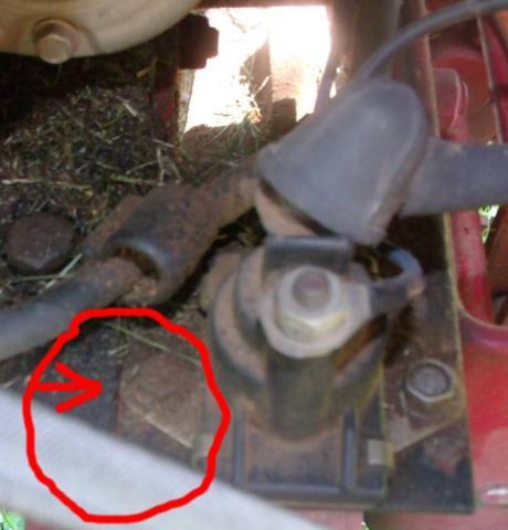

Torino 15 #1 Posted July 19, 2013 (edited) It is hard to see but there is a split there. Is it suppose to be like that or is it a crack forming? It is on my "88 520h. I noticed because when I pulled the pto lever the engine moved. Edited July 19, 2013 by Torino Share this post Link to post Share on other sites
Callen 64 #2 Posted July 19, 2013 The bolt right above the red circle with the cable hold down looks loose, don't know about the crack.... Share this post Link to post Share on other sites
KATO 115 #3 Posted July 19, 2013 Hard to see if thats a crack for sure ... looks like it might just be a separation between the two plates. make sure your engine mount bolts are tight as mentioned. Share this post Link to post Share on other sites
ericj 1,580 #4 Posted July 19, 2013 the solenoid plate is a second plate not part of motor mounting plate. my 96 520-H had the same problem recently, the motor mounting plate bolts were loose not the same as the motor mount bolts, the mount plate ,bolts are under the motor and and a little more difficult to get to with out pulling the motor loose i believe i was doing a motor swap so it was no big deal for me eric j Share this post Link to post Share on other sites
Torino 15 #5 Posted July 20, 2013 That's good news. Lot easier tightening up some bolts then taking the engine out and doing some welding. Share this post Link to post Share on other sites
