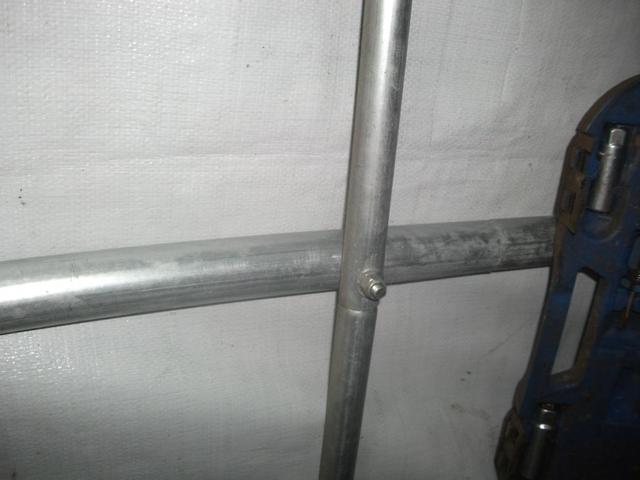

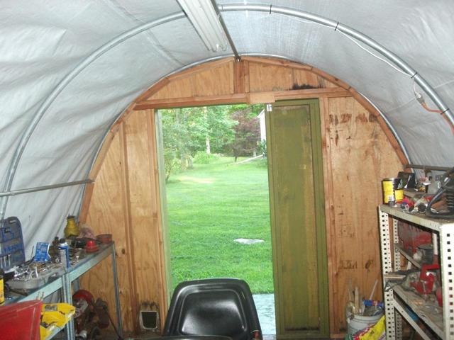

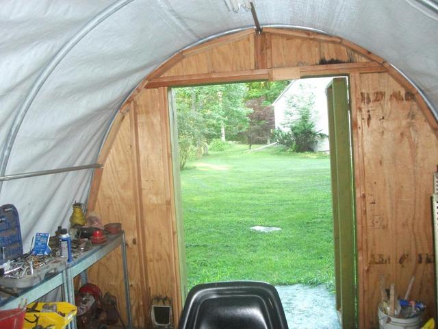

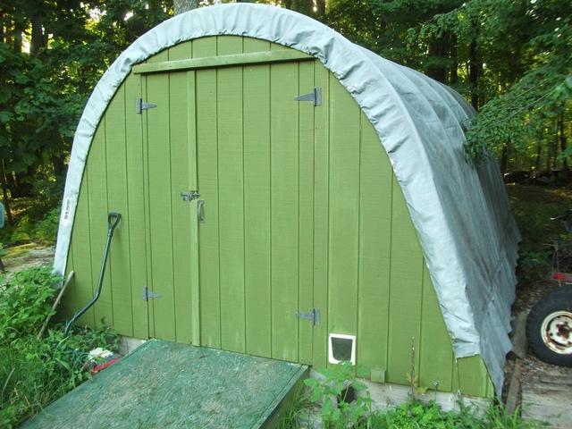

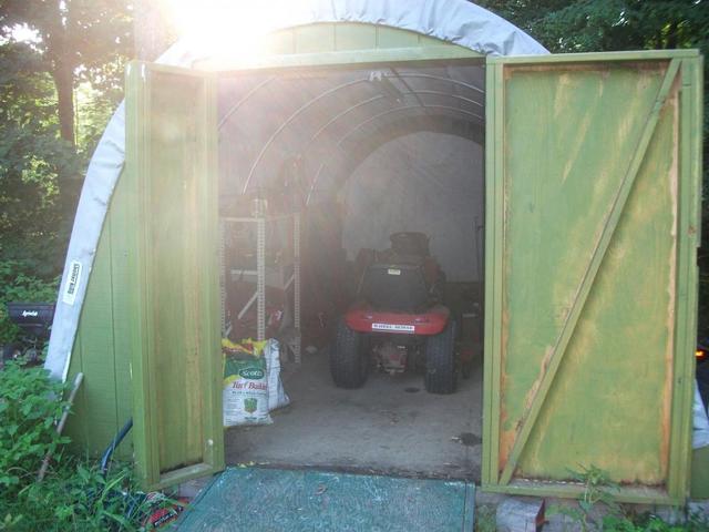

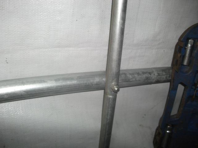

Sparky-(Admin) 23,986 #6 Posted July 14, 2013 I put up a Shelter King brand 12x20 many years ago and the steel frame has been fine. I built a 12x20 pressure treated frame with 3/4 T&G plywood for a floor and its also been great. My tarps roof generally last me 4-5 years before the suns UV rays weaken it to the point that I can poke my finger thru it with no effort (and they leak ). I ended up with 3 extra covers so I just do a swap when it gets weak. I suppose I could cover the weak tarp with a hardware store tarp when my final top is finished. The poles seem to be thick-walled pipe and not the flimsy painted white poles that the Harbor Freight kit gets you. I have had no issues with sagging or bending. I did not have any extra ends or doors so when the one end/door that I used gave up (zipper) I ended up building a wood front with double hinged doors. With the framing underneath its a nice clean place to work if need be, plus it never turns to mud inside. Mike............ 2 Share this post Link to post Share on other sites
AMC RULES 37,250 #7 Posted July 14, 2013 Does look really nice Mike...I like the enclosed hard sides. Share this post Link to post Share on other sites

varosd 1,185 #14 Posted July 15, 2013 I put up a Shelter King brand 12x20 many years ago and the steel frame has been fine. I built a 12x20 pressure treated frame with 3/4 T&G plywood for a floor and its also been great. My tarps roof generally last me 4-5 years before the suns UV rays weaken it to the point that I can poke my finger thru it with no effort (and they leak ). I ended up with 3 extra covers so I just do a swap when it gets weak. I suppose I could cover the weak tarp with a hardware store tarp when my final top is finished. The poles seem to be thick-walled pipe and not the flimsy painted white poles that the Harbor Freight kit gets you. I have had no issues with sagging or bending. I did not have any extra ends or doors so when the one end/door that I used gave up (zipper) I ended up building a wood front with double hinged doors. With the framing underneath its a nice clean place to work if need be, plus it never turns to mud inside. Mike, Nice cat flap! Share this post Link to post Share on other sites
