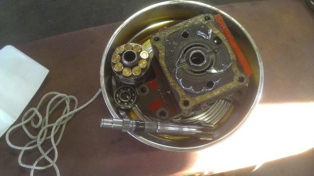

jeremi3210 759 #1 Posted July 14, 2013 Hello i need to get my hydro motor from my d200 apart to rebuild it. Anyone have any pointers on how to get it apart? Read that one needs a press to do it? Any help would be great thanks. Jeremi Share this post Link to post Share on other sites
pfrederi 21,274 #2 Posted July 14, 2013 Check out the videos located in the how to section http://www.wheelhorseforum.com/forum/106-how-to-videos/ You do need a press. You should also down load the Sundstrand manual. Unless it is broken acceleration valve In my experience if the motor has problems so does the pump. Good luck. There are several of us here who have done this. Let us know what you need and what your symptoms are. Share this post Link to post Share on other sites
daveoman1966 3,884 #3 Posted July 14, 2013 If rebuilding the hyd motor, why not also rebuild the hyd pump. To rebuild one and not the other may be a futile exercise as they share the same (contaminated / dirty) fluid that has one or the other performing poorly. They also have nearly identical internal brass components that would, by definition, wear out or scar equally. My question is: how do you know that it is the hyd motor needing rebuild and not the pump? You can use an arbor press to get the shaft out of the hyd motor and it only takes a couple hundred lbs pressure. Not sure where, but the Sundstrand manual for this unit is available in one of the Yahoo Wheelhorse clubs. Share this post Link to post Share on other sites

jeremi3210 759 #6 Posted July 15, 2013 Ok. Got it apart as far as i can without a press. Dont look good, slippers are scratched and the valve plate is pitted very bad. Gonna have to look for parts. Share this post Link to post Share on other sites
coldone 35 #7 Posted July 15, 2013 (edited) LJ fluid power in MI. (269) 623-4150 You will need to talk to LJ and have the wheelhorse part numbers. Dont remember how expensive the rotating group is or the valve plate but it wasnt cheap. I believe that the sundstrand 15 series "thin valve Plate" can be made to work in the motor. The center hole will need to be enlarged to fit around the shaft bearing. You can check ebay for the plate. It would probably be cheaper to try your luck with used motors from ebay. ETA: just reread your last post, you shouldnt be able to see the valve plate wihtout pressing the cylinder group off. If you are talking about the plate that the slippers ride on, thats the swash plate. Slippers can be polished and the swash plate can be lapped. Can you get some pics so we can see the damage? Edited July 15, 2013 by coldone Share this post Link to post Share on other sites

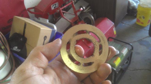

jeremi3210 759 #8 Posted July 15, 2013 Iam talking abouy the valve plate cant get a real good look at it but from what i can see it aint good. I will post pic when i do get it apart. Share this post Link to post Share on other sites
jeremi3210 759 #9 Posted July 15, 2013 Here is the best pic i can get right now. Share this post Link to post Share on other sites
coldone 35 #10 Posted July 15, 2013 OUCH! That left a mark. The bottom side of the cylinder block is going to look rough too. I will wait for disassembly before I pass judgement on it. You may want to watch ebay for a cheap hydro motor. The ones from the c series should work also so you dont have to limit your search to D's. Share this post Link to post Share on other sites

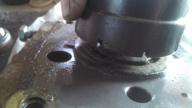

jeremi3210 759 #14 Posted July 20, 2013 Ok so i got my other motor i just got from joes outdoor apart i will let the pictures do the talking. The only thing good in it was the valve plate aftet a bunch of sanding. Hopefully between the two motors i can make one work. Share this post Link to post Share on other sites

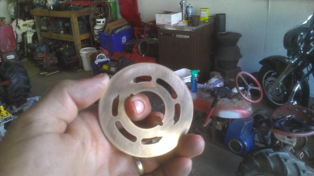

jeremi3210 759 #15 Posted July 20, 2013 Heres a pic of the first plate after sanding. Share this post Link to post Share on other sites
jeremi3210 759 #16 Posted July 21, 2013 Got the motor put back today and success!!! Works great thanks for all the help. 1 Share this post Link to post Share on other sites

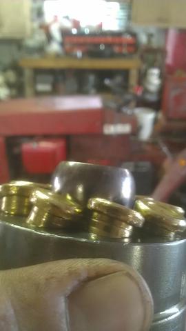

coldone 35 #17 Posted July 22, 2013 Another happy ending! Glad it worked out for you. I wonder what caused the slippers to round over like that. Share this post Link to post Share on other sites

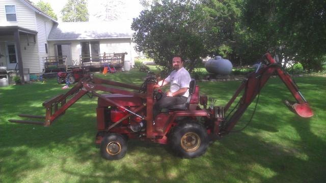

jeremi3210 759 #18 Posted July 29, 2013 Finally got the rest of the tractor back together today. Cant wait to get it out and use it. Share this post Link to post Share on other sites
coldone 35 #19 Posted July 29, 2013 Oh thats sweet! Great looking setup. Share this post Link to post Share on other sites
pfrederi 21,274 #20 Posted July 29, 2013 Like that back hoe!!! Share this post Link to post Share on other sites
JamesBe1 84 #21 Posted July 30, 2013 Awesome! The backhoe is really cool. Share this post Link to post Share on other sites
