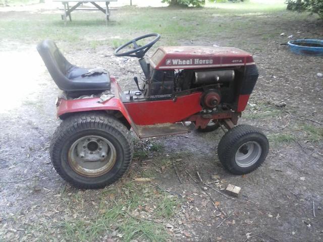

BretzFamily 1 #12 Posted July 21, 2013 Almost forgot to thank you all and let you all know. I'm up and mowing. have more questions but will post them where they belong. i also enclosed a.picture of my horse Share this post Link to post Share on other sites
Jeff-C175 7,211 #13 Posted July 21, 2013 Tell us what you found! Inquiring minds want to know! Share this post Link to post Share on other sites
BretzFamily 1 #14 Posted July 21, 2013 Bad safety interlock switches. pedal switch was under dry grease/grass . Also bad selenoid i can hit it and it start soon as the starter engages. That is what my final conclusion is. It was so simple i totally made it a mess at first. It was a mess but i got it running right the carbs were easy to set. For a twin opposed i thought it would be louder/higher rpm. Is there an governor adjustment or is it just that way. Share this post Link to post Share on other sites
