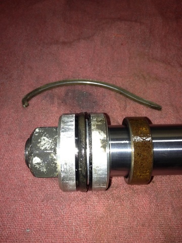

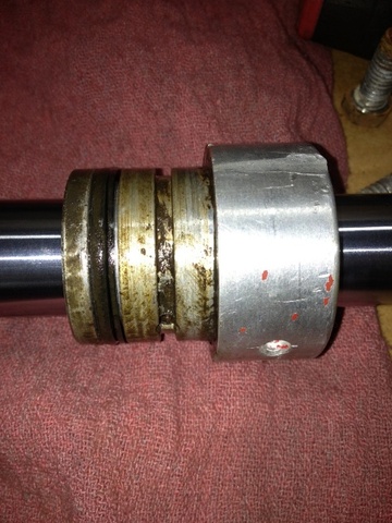

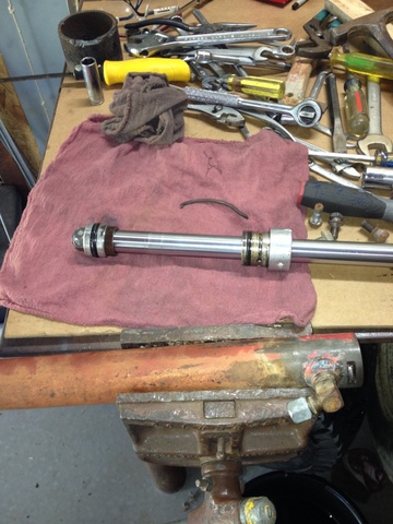

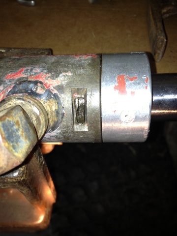

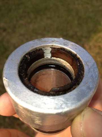

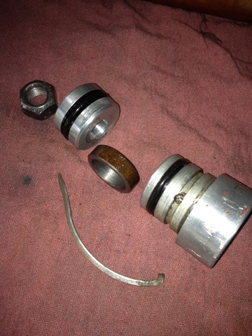

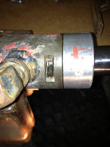

brandonozz 168 #3 Posted July 4, 2013 Well here is what I have so far. Let me start by saying I am not a hydraulic guy and have never pulled a cylinder apart before so if my terminology is incorrect I appoligize. If you are a hydraulic guy (girl) feel free to share any pointers. My first problem was getting the end cap out and I was a bit worried because I had no idea how to get it out. I thought the end cap would screw out with a spanner wrench but after turning it it didn't do anything. You will notice the slot just above the end cap in the first picture. Here is a picture after the end cap is removed with rod, piston and end cap. In this picture you will see a close up of the piston and the retaining clip that has to be removed from the slot to get the end cap out. Not sure you can see but the clip has a 90 deg. bend on one end that will sit in a hole in the end cap. This is used to drive the clip out or pull the clip back in during reassembly. You will need to get a narrow tool like a screwdriver to get the clip started out. A spanner wrench can be used to turn the end cap but I used channel locks over a rag and it turns fairly easy. Turn the end cap until you find the two ends and then get the screwdriver under the loose end and turn to get the clip to "peel" out. Once you get it out a bit you can remove the screwdriver as the slot is tapered. Removing the locking nut will get everything off the shaft. Here is a picture of the end cap. End cap will need an O ring and backing ring on the outside sealing against the case and an O ring, backing ring and wiper/dust seal on the inside to seal against the shaft. The piston has an o ring and two backing rings. There is also an o ring on the shaft under the piston but I'm not replacing mine as it was pretty tight to get the piston to slide off the shaft so I think it's in good shape. This loader hasn't been used for more than 5 years but the oil inside still looked pretty good. I hope the oil in the uprights is looking good as well. Been a few months getting the trans rebuilt and the loader is the next step. 1 Share this post Link to post Share on other sites

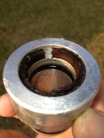

brandonozz 168 #7 Posted July 5, 2013 James, I definately was scratching my head when the end cap didn't come out when I started turning it I knew the slot had to be there for a reason it just took me a few minutes to figure it out. The wiper seal fits into a recessed groove in the end of the end cap. To replace you will have to pull it all apart to get it installed. My seal is toast and falling apart (likely a contributing factor to the o ring wear) but it looks similar to any oil seal but without a spring. The seal is "L" in shape with the sealing surface 50% wider than the part that fits down into the recess. Sorry the parts in the first pics were dirty - I snapped them before I cleaned them up. Here are a two more including the O ring under the piston. I'm not sure how important it is to replace the backing rings but I'm going to look for some. I guess its going to be a manual search as I haven't been able to find any numbers on the interweb for the parts so I can cross-reference. Not much parts information out there on these cylinders from what I can find. Share this post Link to post Share on other sites

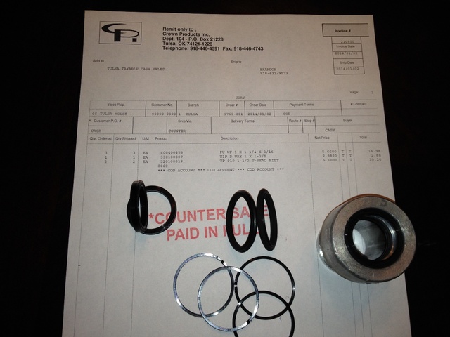

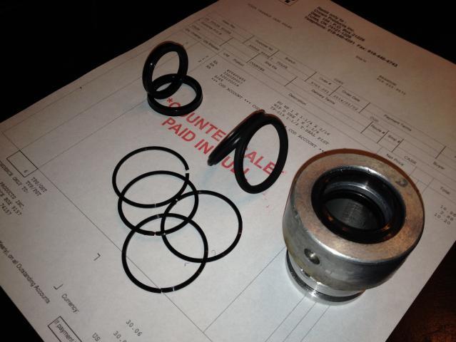

brandonozz 168 #10 Posted July 5, 2013 Did you see the Ark manuals in the manual section here? Do a search for Ark and they will come up. Garry Garry, I had looked at the manuals and I see they had a replacement O ring/seal kit but no parts listed for the kit. I figured I would need to go hunt the parts and do the best I can. Maybe you can locate a hydraulic cylinder repair shop to help you out. KC9KAS, Well I took your advice.... Kinda. Both of the major seal suppliers in Tulsa were closed today so I called a hydraulic cylinder repair shop. He confirmed both shops were closed as he had checked also. He was a great guy and offered to try to match the parts with what he had in stock so I went over to give it a shot. The good news.... he said the backup rings next to the O rings are only there to support the O rings on the pressure side and didn't need to be replaced. He found both the outer O rings and the one inner O ring and even found the seal for the 1" shaft. The bad news is that I didn't get any part numbers to list here for reference but I think anyone could match up what you need at a seal distributor like Sealco or Crown here in Tulsa. I got to say, this guy knows his cylinders! I asked about wear on the inner sleave of the cylinder and he said he doubted there would be any problems so thats a good thing. He also said this type of cylinder is easy to work on as long as you don't break the "90" on the retaining clip when your trying to get it apart. If the "90" breaks when removing the clip you will likely need to take to a shop that can get it out costing you some $$$. So, when you first start turning the end cap preparing to get the clip out I would soak the groove with some PB Blaster if you find too much resistance in the event the clip has rusted to the outer case. This "old timer" not only found my parts but installed them in the piston and end cap and wouldn't even take my money! That is the type of place I will spend my money when I need some work done! Share this post Link to post Share on other sites

KC9KAS 4,746 #15 Posted July 7, 2013 I just checked my cylinders on my 550, and all 4 of them have an internal snap ring on the rod end. Share this post Link to post Share on other sites

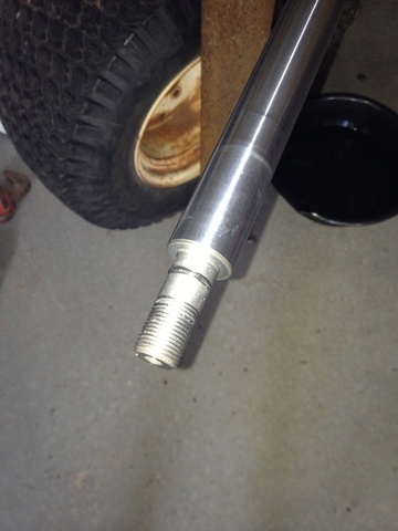

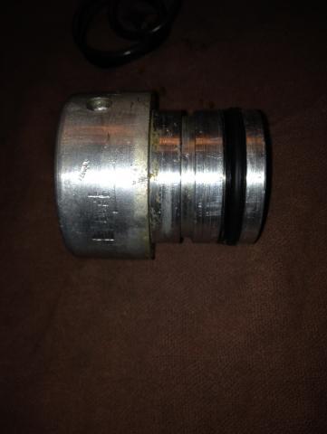

brandonozz 168 #24 Posted January 4, 2014 Got the D 200 out two days ago and went down to my neighbors house to help him move some compost. Two or three buckets in I had another seal fail and started leaking badly. I had only had time to get one of the cylinders repaired this past summer and knew I was on borrowed time. I used the loaded several times thru the summer with no leaks but the cold weather had it's way with the old brittle seal. One thing of note from the teardown. I relayed some information previously in this post about the backing rings for the "O" rings that had been told to me by the hydraulic repair guy. He said that they didn't need to be replaced as they just support the "O" rings. I will now disagree with him as that is exactly the part on the piston that failed and I would replace with new if they show any signs of wear. The seal supplier where I picked up my new parts recommended different types of seals for the piston and shaft seal and said they were much better than the "O" rings so that is what I bought and figured I would give them a try. Note the "T seal" for the piston is almost shaped like a tri rib tire and the backing rings come with the T seal as a kit and are split for getting them in place easily. These seals are made of a harder type of plastic except for the wiper on the outside of the end cap which seems a bit softer. The seal on the outside of the end cap is a standard "O" ring with a backing ring. Please note I was buying parts for three other cylinders but they didn't have everything I needed so the quantities are not correct for what you need. Here are a few pics with the invoice for part numbers I'll get these new seals installed and report back if I have any problems. 1 1 Share this post Link to post Share on other sites
