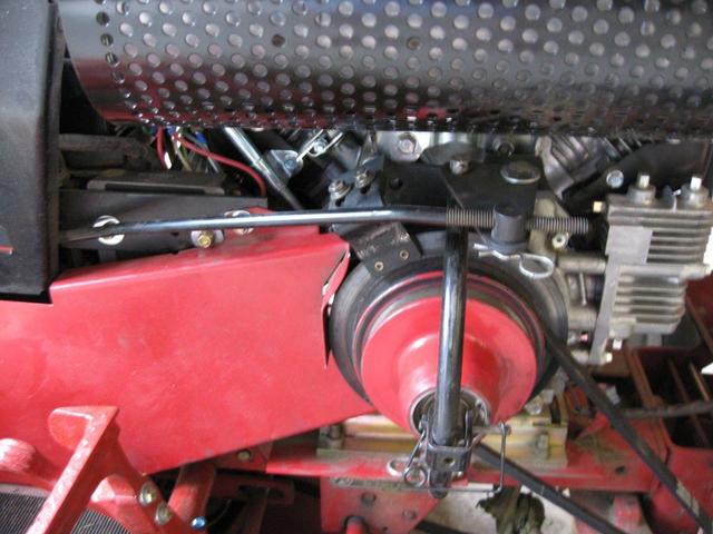

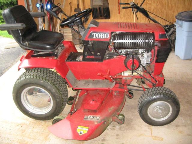

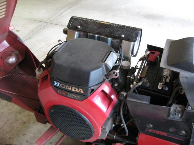

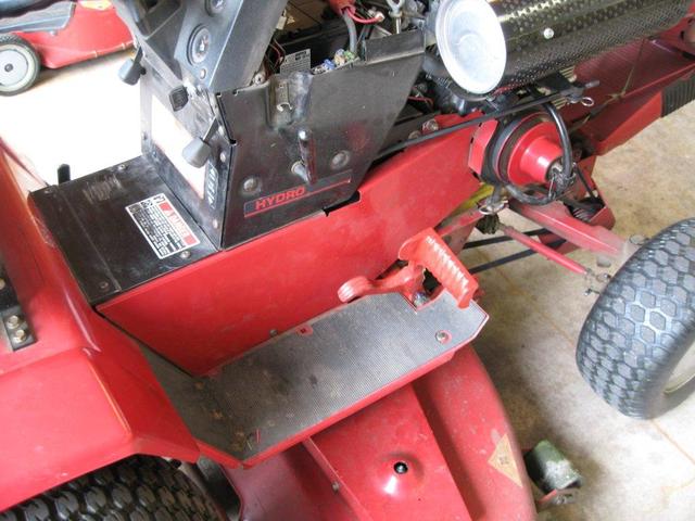

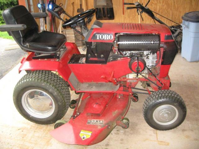

Red-Bovine 337 #1 Posted July 3, 2013 Just finished up installing Matt's Hydro foot control and doing some maintainence and belt replacing. The conversion was very easy and the instructions and parts Matt provides are first rate. It took about 3-4 hrs for the actual conversion with no problems or alterations other than drilling the holes for the nuetral positioning bearing and the spring associated with it. Nice Job, Matt!!!!! Here are some pics of my 520H with the new control and the Honda muffler I decided to use. The muffler that came with the Honda kit was too close to the PTO linkage. The Honda muffler also has a heat shield. I did have to cut into the hood, but it does not look bad or adversely affect the tractor. I replaced all the belts and cleaned out years of crap around the transmission and other areas. I also cleaned up the mower deck tensioner and got that working properly again. Red 4 Share this post Link to post Share on other sites
JackC 619 #2 Posted July 3, 2013 Looks great. Nice clean conversion. 1 Share this post Link to post Share on other sites
rexman72 210 #3 Posted July 3, 2013 looks like it came from the factory 1 Share this post Link to post Share on other sites
thehorse 221 #4 Posted July 3, 2013 Nice job and looks good. 1 Share this post Link to post Share on other sites
squonk 47,887 #5 Posted July 4, 2013 That Honda looks mean! Share this post Link to post Share on other sites
dbartlett1958 99 #6 Posted July 4, 2013 You are going to love that tractor even more with that foot pedal conversion. I love mine and cannot imagine going back to the lever between your legs, or in your case, on the column. 1 Share this post Link to post Share on other sites

Wheel-N-It 2,978 #9 Posted July 5, 2013 The whole thing looks great! Nice upgrades. That was money well spent! Share this post Link to post Share on other sites
Red-Bovine 337 #10 Posted July 7, 2013 Thank you!! Just got done with the first mowing job with the new pedal. It is great!!!! There was a little learning curve after using the lever for over 21 years, but I quickly adapted. Just go slow, especially in close quarters, until you get a good feel for the new pedal. I had a tendancy to reach for the lever (not there anymore) when wanting to stop fast. I like leaving a small amount of drag on the linkage to prevent my foot from bouncing on the pedal in rough grass and to allow a slight autopilot mode in forward. This makes for a smoother ride, but also slows the pedal's return to neutral. Just my preference. Reverse, due to the short throw, does come backto neutral more quickly and will jerk to a stop unless feathered with you foot. All things to remember and will become natural over the learning curve. I really like the new setup. Toro should have made this the standard. Glad Matt had the vision to market this kit. Red Share this post Link to post Share on other sites

peter lena 10,014 #14 Posted August 6, 2022 @Red-Bovine love those Hondas , very solid , super efficient , very reliable , as you get hours on that you will correct areas to make it look original , that base side panel for your pto lever can be replaced , you could also add a few metal punch holes in the belt guard area just in the back side of the pto belt area , to let that hot cylinder air blow thru. that will enhance hot air discharge . would also give that an aerosol lubrication soak down , to save that paint , very easy to do , and can be working while you are doing other things. looks like a very good project , pete 2 Share this post Link to post Share on other sites
davem1111 2,314 #15 Posted August 6, 2022 7 hours ago, peter lena said: @Red-Bovine love those Hondas , very solid , super efficient , very reliable , as you get hours on that you will correct areas to make it look original , that base side panel for your pto lever can be replaced , you could also add a few metal punch holes in the belt guard area just in the back side of the pto belt area , to let that hot cylinder air blow thru. that will enhance hot air discharge . would also give that an aerosol lubrication soak down , to save that paint , very easy to do , and can be working while you are doing other things. looks like a very good project , pete Great advice, Pete. Oh, I also need to replace the PT 2x4 wood braces the PO or someone used to raise the engine to the proper level (or close...). I'm planning to use square steel tube stock. Need to do some measuring first, because I think those are the reason I had to go with a non-standard drive belt length. 1 1 Share this post Link to post Share on other sites
