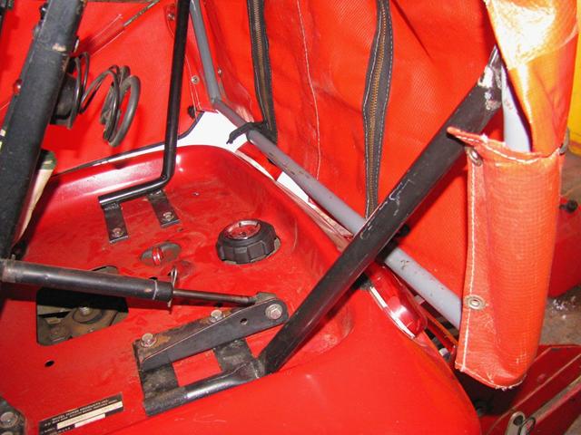

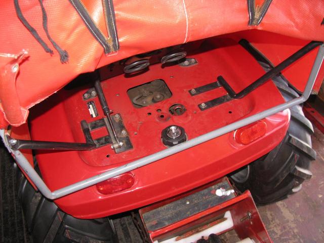

KC9KAS 4,741 #4 Posted June 27, 2013 I have the same problem. I have been in contact with Original Cab Company and they said there should be a model number near the back window....Mine was missing. I have taken pictures to send to them so they can help identify what model I have. 1 Share this post Link to post Share on other sites

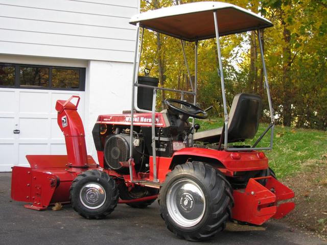

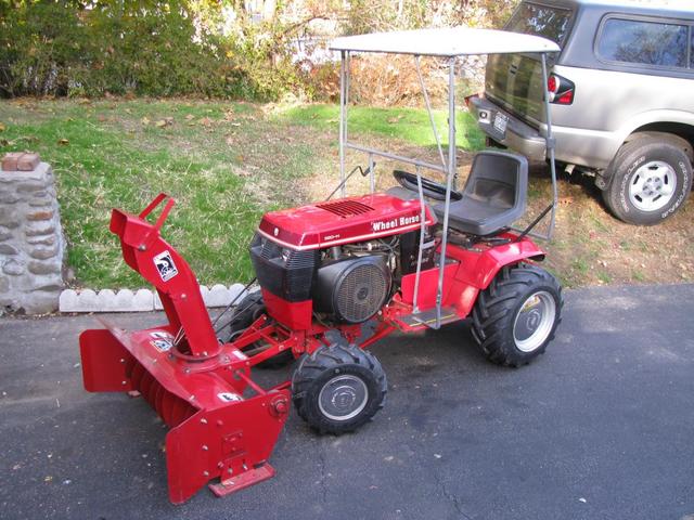

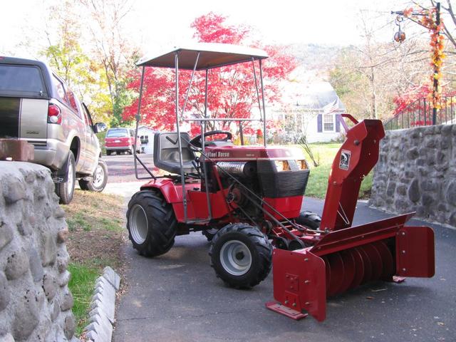

AMC RULES 36,954 #5 Posted June 27, 2013 (edited) The frame work mounted on my 520...maybe a couple picts will help you figure yours out. Edited June 27, 2013 by MAYHEM '13 1 Share this post Link to post Share on other sites
KC9KAS 4,741 #6 Posted June 28, 2013 Thanks Craig.....On your GT...the brackets that are mounted under the seat (where gas shock is mounted).......I have those type of brackets, but from some of the manuals I have seen, mine would mount on the front of the foot rests under the brake/clutch pedel(s). I am missing what-ever bracket mount on the rear of GT, but once I get the cab sitting over the GT, I will make something that works. Share this post Link to post Share on other sites
