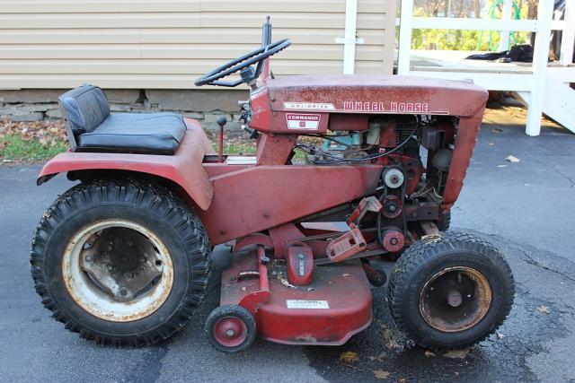

steve k 82 #1 Posted June 27, 2013 (edited) After cleaning the carb on my commando 6 this damn tractor is becoming one of my favorites!! However, the muffler(stock) is so darn loud. Is the exhaust port tapped with pipe thread or are there quiet "two bolt" mufflers available? Thanks! Steve Edited June 27, 2013 by steve k Share this post Link to post Share on other sites
illinilefttackle 399 #2 Posted June 27, 2013 Steve- the answer is "yes" & "yes". The port is threaded and there are 2 bolt mufflers out there- examples-HH-60 with a stack and H-70 on a snow blower with a flat 2 bolt muffler-Thanks-Al Share this post Link to post Share on other sites
