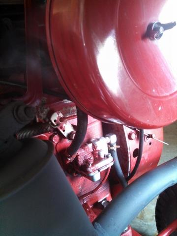

608KEB 829 #1 Posted June 25, 2013 My 75 C-100 has a fuel leak from the fuel pump fitting. Can I use white teflon tape? any suggestions other than that would be great. Share this post Link to post Share on other sites

608KEB 829 #3 Posted June 25, 2013 It the fuel pump fitting. It screws into the fuel pump on the engine. I noticed the paint had lifted off the fuel pump. It is a little loose Do I have to use yellow Teflon tape when I re-tighten it? Share this post Link to post Share on other sites
multihobbyguy 35 #4 Posted June 25, 2013 I have always used white. I am not sure if it is right or wrong but it has yet to cause me any troubles. Share this post Link to post Share on other sites
rmaynard 17,231 #5 Posted June 25, 2013 Oops, I'm thinking fuel tank. Must be the Stevasaurus wine that I had for dinner. Sorry, Teflon tape is okay, but I always use a pipe thread compound that is made for gasoline and other fuels. Yellow tape is made for natural gas and propane, but it is the same as the white tape, only thicker. Share this post Link to post Share on other sites
608KEB 829 #6 Posted June 25, 2013 O.k. I'll use the white Teflon tape. I think Stevasaurus lives in my neck of the woods. I guess I'm missing out on the wine! Share this post Link to post Share on other sites
Jeff-C175 7,209 #7 Posted June 26, 2013 I personally would never use teflon tape on a fuel system. Those little slivers of teflon that separate from the tape when you screw the fittings in can really muck up the works... but, that's just my NSHO ... your mileage may vary. Share this post Link to post Share on other sites
608KEB 829 #8 Posted June 30, 2013 I decided to use Teflon paste. The problem was when I tightened up the fitting it was pointing straight down. The fitting that was loose, was the one that goes from the fuel pump to the carburetor. I needed it to point up. I hope this works. I was going to let the paste set for a week. Share this post Link to post Share on other sites
rmaynard 17,231 #9 Posted June 30, 2013 ... I was going to let the paste set for a week. Using it now, or letting it set makes no difference. Teflon paste never hardens, and it is ready to use as soon as the fitting is installed. Share this post Link to post Share on other sites
608KEB 829 #10 Posted July 8, 2013 Didn't know that about the Teflon paste. I mowed today and had no problems! Share this post Link to post Share on other sites
