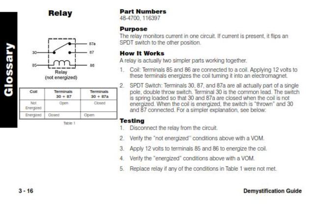

gwest_ca-(File Mod) 12,418 #11 Posted March 11, 2015 After searching many posts about this problem, I still don't know the answer to my problem. I saved a Maroon hood 310-8(no model # decal)from the scrap guy and it had been abused big time...but the Kohler is like new (maybe the PO installed it and didn't know anything about wiring.) All the wiring was removed and in a bucket....I have a wiring diagram and everything looks straight forward...EXCEPT this item: RELAY connections. It show 3 wires connected to the relay....two blue wires that go to the engine oil switch...one purple wire that goes to the solenoid. I need to know the correct way to connect the wires to the relay ..the relay has 3 terminals coded......H-B-S Can I assume the purple wire is connected to the "S" spade? (yea, I know about assume)....thanks in advance for your comments. Can't find anything on the 106833 relay other than it has been replaced by 99-5365. This service bulletin indicates some used a 116397 relay and found this shot of the 116397 relay Is there a diagram on the relay cover? Adding - pop the cover off and identify the terminals that way. Garry Share this post Link to post Share on other sites
