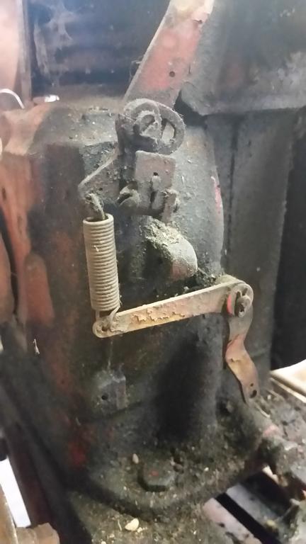

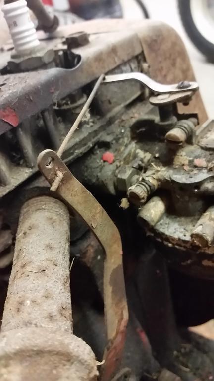

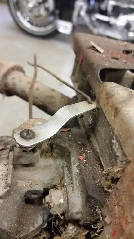

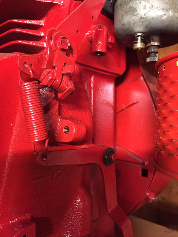

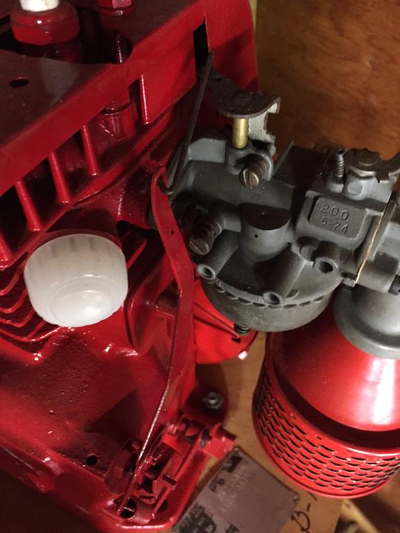

SMITTY 23 #7 Posted June 1, 2018 Hi Charlie Im having problems with the governor on my 1200 on my Rj Do you have a picture of the throttle set up. Been trying to get one from Vinsrj no help Thanks Smitty Share this post Link to post Share on other sites
WHX?? 56,605 #8 Posted June 1, 2018 (edited) Doubt your gonna get an answer from Charlie Smitty, he's not on here much anymore. Maybe these will help. From a pre-tear down inspection. I can get you some post assembly pics too. Edited June 1, 2018 by WHX19 2 Share this post Link to post Share on other sites

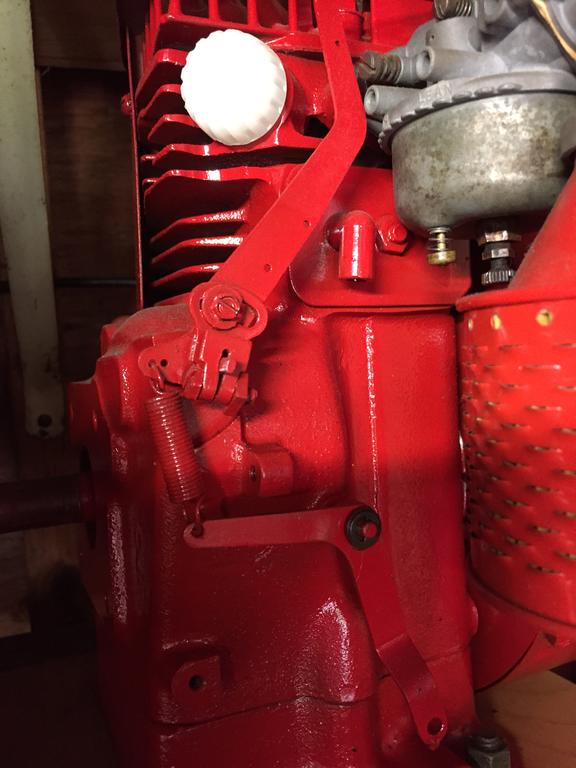

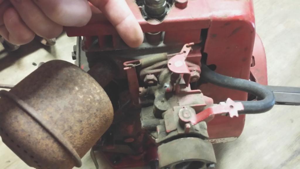

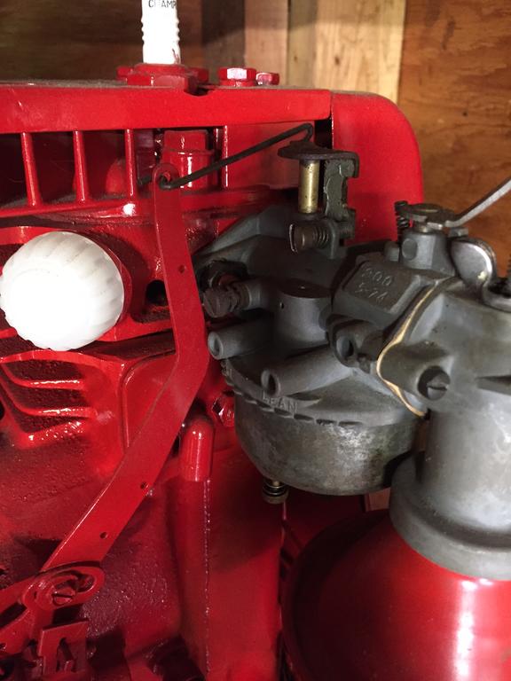

formariz 12,359 #9 Posted June 1, 2018 (edited) @SMITTY I have a few of the engines built by Charlie still unused. Will get a few photos a little later. Edited June 1, 2018 by formariz 1 Share this post Link to post Share on other sites
VinsRJ 723 #10 Posted June 2, 2018 Hello, the pics supplied are spot on to what is needed for a Clinton throttle set up except all of the motors are missing one critical part. The little spring between the governor arm and the throttle plate. This spring is needed in order to keep the motor from hunting around for the rpm desired... 1 Share this post Link to post Share on other sites
