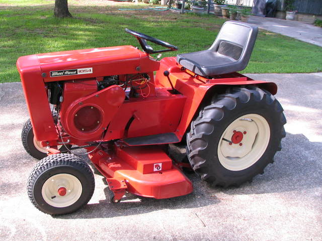

Killer 2000 Chevy 83 #1 Posted June 19, 2013 I have been looking for tires for my 1054. What size are the ag lug tires I see on a lot of the 1054s? Can't seem to find any that are the right size or look right. This is what I am wanting Share this post Link to post Share on other sites

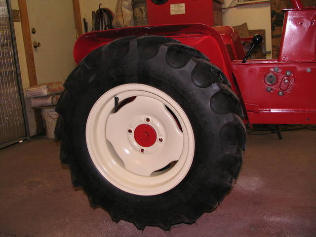

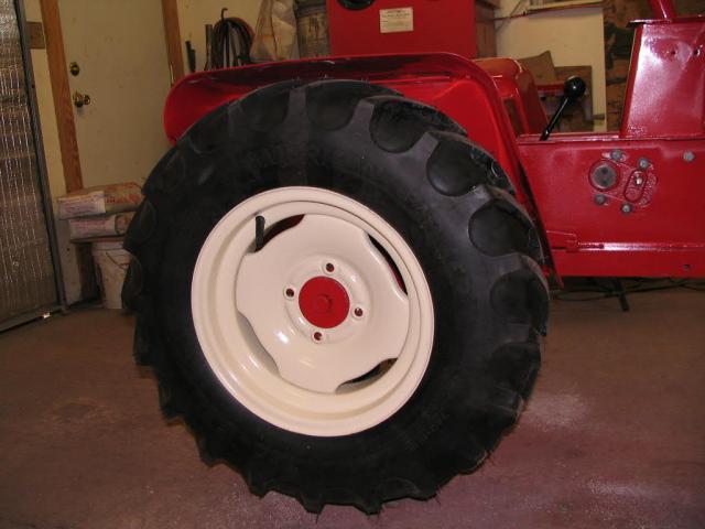

pacer 3,181 #2 Posted June 19, 2013 These from -- http://stopandgotires.com/model.asp?model=Traction%20Implement%20I-3 --may be as close as you can get, the ag tires in 15's just arent out there. I used the 7.6/-15 in these American Farmer, theyre no doubt over sized from the original but I was quite satisfied with the way they look - kinda bad a**! The 5.9/-15 might do, but the originals were 6.40-15 and I was afraid undersized would look worse than oversize There is a bout 1/2 - 3/4" clearance on the front edge and about 1 - 1 1/4" on top, they are 31" tall 1 Share this post Link to post Share on other sites

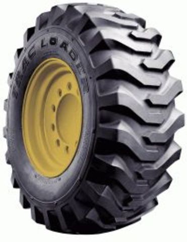

4xfourfun 30 #5 Posted June 21, 2013 The guy I got my 1054 from put Titan Trac Loader tires on it, 27x8.50x15 Here's a file pic I found on-line of the tires: Share this post Link to post Share on other sites
