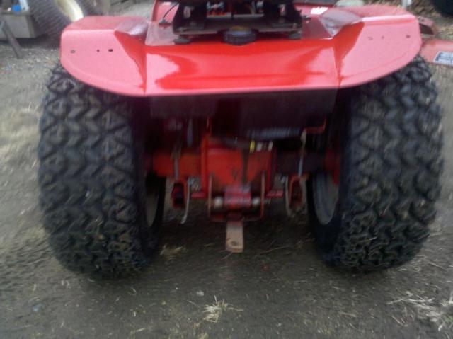

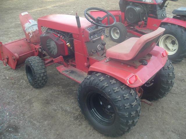

Sparky-(Admin) 26,686 #6 Posted June 15, 2013 Heres what I did. These tires so far have impressed me both in loose dirt and in last winters snow. They have great traction in both forward and reverse. I have about 75#'s of weight on each rear wheel and do not run chains. Mike........... Share this post Link to post Share on other sites

Hydro 131 #9 Posted June 16, 2013 Heres what I did. These tires so far have impressed me both in loose dirt and in last winters snow. They have great traction in both forward and reverse. I have about 75#'s of weight on each rear wheel and do not run chains. Mike........... Yeah that's the post I remember. I'd trade both my sets of tires for one set of those. One & done! Share this post Link to post Share on other sites
chrisd200(inactive) 56 #10 Posted June 16, 2013 Heres what I did. These tires so far have impressed me both in loose dirt and in last winters snow. They have great traction in both forward and reverse. I have about 75#'s of weight on each rear wheel and do not run chains. Mike........... Yeah that's the post I remember. I'd trade both my sets of tires for one set of those. One & done! Those look really AWESOME! Share this post Link to post Share on other sites

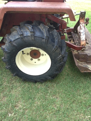

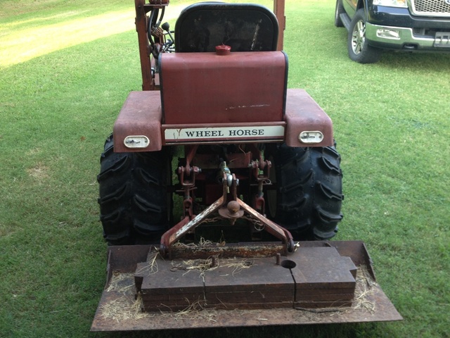

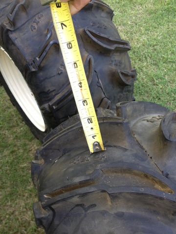

brandonozz 168 #13 Posted August 9, 2013 Finally got some tires for the D and went with some Carlisle 26 X 12.5 X 12 tires with 1.5" deep lugs. When I first saw them on CL they put a smile on my face and had to get them. Brand new never mounted for $125 for the pair. I havent got to play with them much but I think they might be a little better than the turfs I pulled off The only problem was getting the tires onto these rims! What a PITA. It's like trying to seat the tire for 6" with those rims that have the large diameter on half the width of the rim. Thanks for everyone's advice- I think I'm going to like them! 1 Share this post Link to post Share on other sites

brandonozz 168 #22 Posted August 12, 2013 The local lube/tire shop broke down the old turfs off the rims and I stripped the rims down to the metal and primed and painted them. Took them back a few days later and they remounted the tires. Doing these by myself was not worth the $12 they charged me to dismount and and mount! Actually, at 5 times that price I wouldn't want to do it! Share this post Link to post Share on other sites
