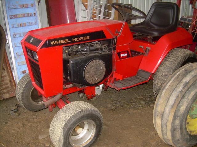

Tankman 3,528 #6 Posted June 12, 2013 Take a peek-a-boo in my gallery. Most of the footrests have this on 'em http://shop.ccs.com/product/model:119559/sku:61-33654/mob-perforated-grip-tape/black/&SID=7284&inceptor=1&cm_mmc=SEM-_-Engine-_-Google-_-Plusbox Been using coarse grip tape for years. Easy to apply, stays put, inexpensive. I did bookmark amcrules00 link, nice. Thank You! 2 Share this post Link to post Share on other sites

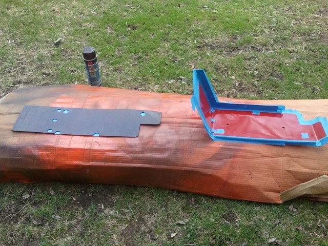

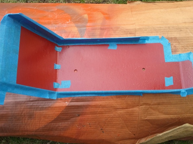

Catt 13 #9 Posted June 12, 2013 I used Classic Kitchens and 3M #80 spray adhesive. I used masking tape for the outline and to cover the holes to keep the adhesive off some areas. I sprayed both the mat and the metal per the instructions. It holds really well. I didn't have a final picture of the floor board (just the whole tractor). 1 Share this post Link to post Share on other sites

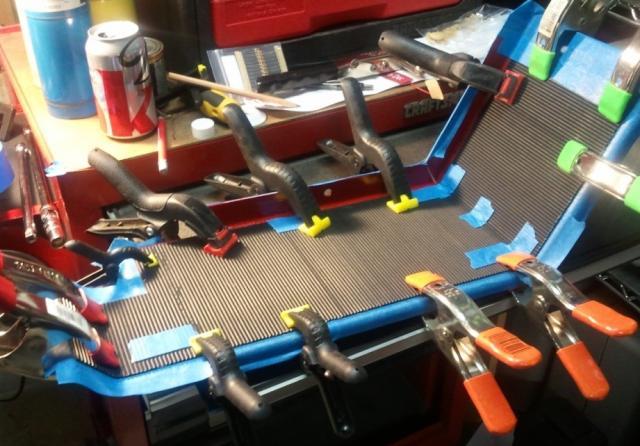

lynnmor 8,903 #21 Posted December 6, 2019 Perhaps this material will work for you. Share this post Link to post Share on other sites
