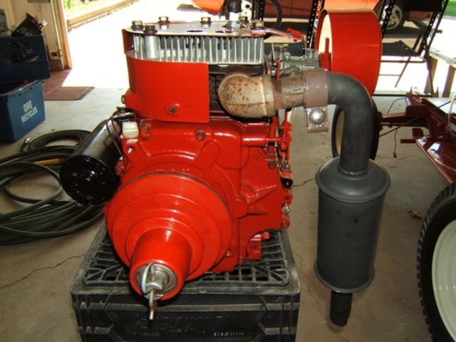

KATO 115 #3 Posted June 6, 2013 If you look at the muffler on the motor in my avatar it was painted with flat black BBQ paint a year and a half ago and it still looks good !! :handgestures-thumbupright: 1 Share this post Link to post Share on other sites

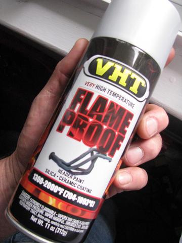

AMC RULES 37,259 #4 Posted June 6, 2013 BBQ paint is good, this is better. 3 Share this post Link to post Share on other sites
SousaKerry 503 #5 Posted June 6, 2013 Yup that's the stuff Share this post Link to post Share on other sites
Anglo Traction 761 #6 Posted June 6, 2013 BBQ paint is good, this is better. That makes me Craig. So do they make NON Flame proof VHT Paint as well?. 1 Share this post Link to post Share on other sites

AMC RULES 37,259 #8 Posted June 6, 2013 BBQ paint is good, this is better. That makes me Craig. So do they make NON Flame proof VHT Paint as well?. From the manufacturer's website... http://www.vhtpaint.com/products/flameproof/ Share this post Link to post Share on other sites
