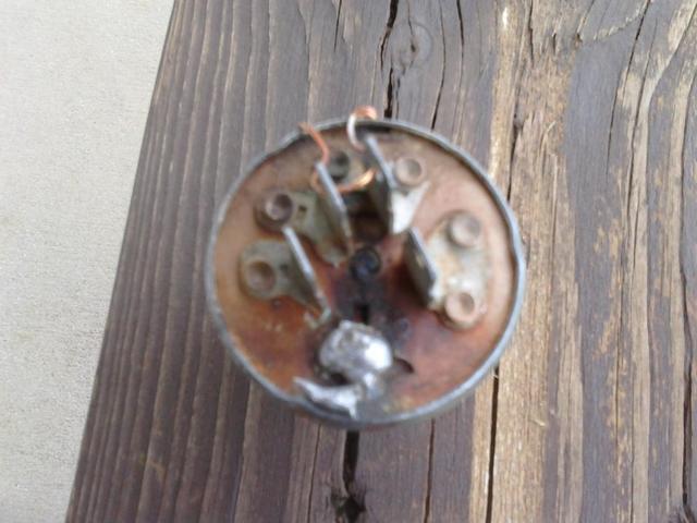

Bluffhunter 39 #1 Posted June 3, 2013 Well, I finally had some extra time to go to my Mom's house to see if I could get the C-161 home to start working on it, and I had recalled that Dad was having some problems with the key switch, and after removing it, I found the (ground ?) wire had been soldered at some point and that wire was no longer attached to the back of the switch. I had tried to hold the wire to the terminal and the tractor would hit but not run. I have attached a picture of the back of the INDAK switch and need to find someplace to buy a new one. Any help would be greatly appreciated !!! Kyle Share this post Link to post Share on other sites

Bluffhunter 39 #4 Posted June 3, 2013 Hi Garry, It appears to be the original switch and it is a 16 H.P. Kohler engine. Model # is 91-16KS01-12166. Hi John, the link shows a 5 blade switch but the blades are not staggered like the picture I attached. It might work but I would have to change the female plug also, which I need also as the one on the tractor is burned a little. Thanks guys ! I am trying to find a Toro dealer in my area as well. Share this post Link to post Share on other sites

wallfish 20,159 #7 Posted June 3, 2013 I'm confused on why the switches on that web site aren't the same as the one you posted. These switches are a pretty standard item. What is staggered different? The 3rd one down is the switch you need for your battery ignition Kohler. You can also get a new 5 terminal harness connector from the same place.http://www.psep.biz/store/electrical_mower.htm Share this post Link to post Share on other sites
gwest_ca-(File Mod) 12,325 #8 Posted June 4, 2013 3rd one down has a 9/16" diameter mounting stem. 5th one down is 5/8" Garry Share this post Link to post Share on other sites
Bluffhunter 39 #9 Posted June 4, 2013 Thanks guys ! After seeing what the new switches looked like mine are not staggered. The one that has been soldered would be beside the other one to the right. Thanks for your input, and I hope to have one ordered today. Kyle Share this post Link to post Share on other sites
