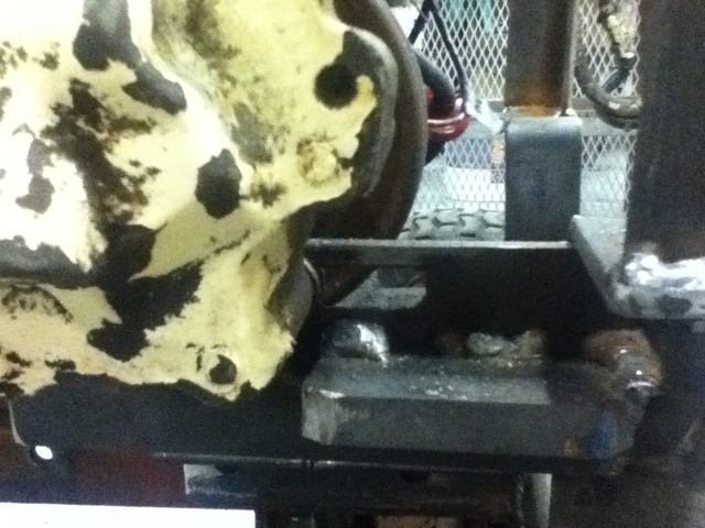

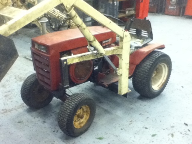

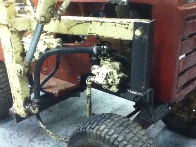

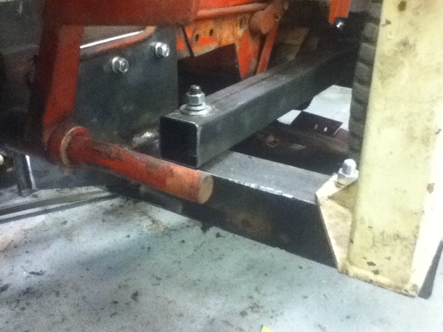

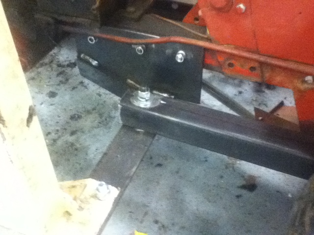

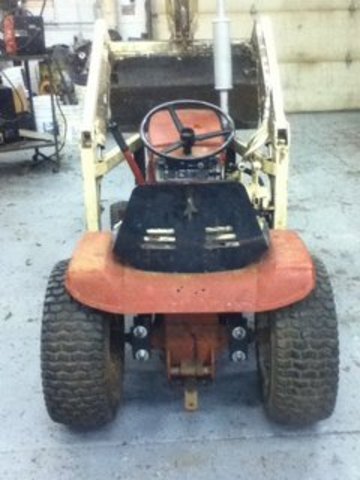

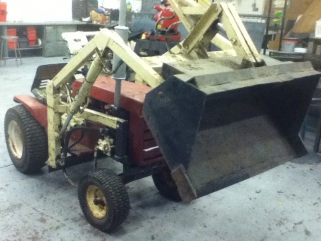

Jdslednut 1 #1 Posted June 3, 2013 I have to admit it. I have been a "looker" on this site for awhile now, ever since I aquired my Raider 14. I sure have learned a lot of neat things about Wheel Horses and how friendly Redsquare members are. I received my Raider through a trade for a Craftsman that I had found as the PO wanted a 2nd mower. The Raider didn't have a deck and he knew I would love to have it as another GT to play with. I was fortunate enough to receive the loader from a friend here in town who told me I could have it if I mounted it on a tractor and brought it to the summer town celebration show. We've been bringing restored big tractors and I've been bringing a few of my GTs to the show as well as running one in the parade with our FFA Alumni Chapter. I couldn't turn down that deal. Here's a few pictures of my loader fit-up to the Raider. It originally was fitted to a CC Original so I went ahead and created a new set of bracketry. Just looking to share what I've done with the help of the forum and to see if you have any other suggestions/comments on the design. I won't be working it too very hard - probably just moving the pile of snow at the end of the driveway when the city plows me in. The next steps for me include making a stabilizer bracket for the exhaust and detemining where the tranny leak is coming from that I discovered today. I should have figured there might be an issue seeing that it was quite low when I topped it off. Thank you again for a great site full of information and good people. 1 Share this post Link to post Share on other sites
dsholler 54 #2 Posted June 3, 2013 The loader is cool, looks like a beast.....but that seat looks a tad uncomfortable.... Share this post Link to post Share on other sites
AMC RULES 37,259 #3 Posted June 3, 2013 Love that FEL...nice retrofit there. Share this post Link to post Share on other sites

rexman72 210 #5 Posted June 4, 2013 welcome that loader looks good Share this post Link to post Share on other sites
Jdslednut 1 #6 Posted June 4, 2013 I drove it over to the loader PO's place tonight. He was full of smiles. I'm glad he was happy with the outcome. Now, hopefully before long I can bring it to him with some shine. Share this post Link to post Share on other sites

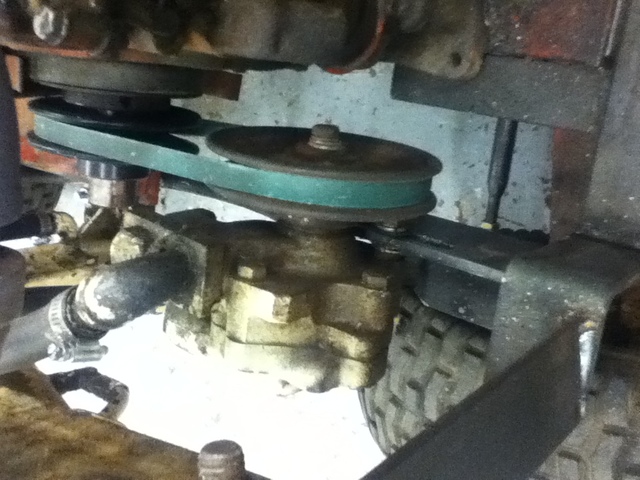

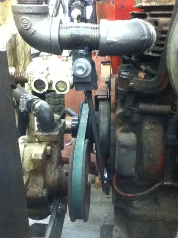

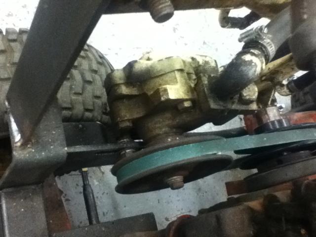

B-8074 20 #7 Posted June 4, 2013 That looks great. I have a johnson loader as well but still haven't mounted it. I'm still working out where to mount the pump. Any chance you could get a few close up pics of how you mounted yours? Thanks. And again, nice job. Share this post Link to post Share on other sites
Jdslednut 1 #8 Posted June 4, 2013 Here's a few close up pump pics. Share this post Link to post Share on other sites
papaglide 542 #9 Posted June 4, 2013 Really nice work, man! Share this post Link to post Share on other sites
Jdslednut 1 #10 Posted June 4, 2013 Ignore the weld quality on the bracket gusset. Eessh! It was a tough spot to get in to and I didn't want to remove it. Got a little time to install an exhaust stabilizer. The loader is cool, looks like a beast.....but that seat looks a tad uncomfortable.... It is just a little uncomfortable. Will be looking for a replacement. Share this post Link to post Share on other sites

B-8074 20 #13 Posted June 5, 2013 Thanks for the pics. That gives me some good ideas. Share this post Link to post Share on other sites
