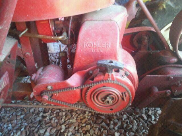

Boombastic86 0 #1 Posted May 28, 2013 I've already introduced myself in the other forum, but I'll admit, I'm going to be a huge noob to the Wheel Horse scene. The tractor I have was a little project of my dad's that he had picked up years ago, but ended up having heart problems and never got to it. As a kid I had a Toro 920 that I had completely rebuilt and painted as one of those "first projects" to get me interested in mowers. Other than that and dabbling with the Jacobsen I have to keep it in usable condition, I'm pretty clueless when it comes to Horses. I know so far that the one I have has a Kohler K91. It has a recoil starter as well, so I'm taking a guess that it's a Suburban 400? The main problem with this one is that the recoil starter is shot on it. Tinkering with it and messing with the springs I've gotten it to go from a free spinning mess to something that actually grabs and will turn the starter cup, but it will either recoil the rope minimally, or not at all. After rooting through it the better part of 3 times today, my final assessment is that it's shot and that I'll have to somehow find a replacement, which apparently is easier said than done. That being said, identifying exactly what year and model this is would be my first shot at actually figuring out just what I can do in terms of getting to the point of even being able to TRY to start it. Share this post Link to post Share on other sites
Jake Kuhn 1,600 #2 Posted May 29, 2013 That is a 1961 suburban 401. The 400 only has a few differences. A 400 has different throttle cables, different foot rests (which were a option), a different clutch pedal, and the hood stand is a little different as it doesn't have holes for the throttle cables to run through like your 401 has. That 401 is in really decent shape! What type of recoil do you have on yours, could you take a picture so we know which one? Share this post Link to post Share on other sites
Boombastic86 0 #3 Posted May 29, 2013 Thanks! I'd tried to do some research so I knew the year range of what it was, but no idea of the differences between the models themselves. As for the recoil, this was a shot I snapped earlier today before the storms started rolling in. I apologize if it's not the best shot, and I'd eventually just put it back together the way I'd found it, which is the way my dad bought it. Share this post Link to post Share on other sites
Jake Kuhn 1,600 #4 Posted May 29, 2013 If that is what I think it is that is part of a factory electric start setup! But I could be wrong. One of the tractornut brothers has 2 of those setups, he will probably respond to this thread. Share this post Link to post Share on other sites

gwest_ca-(File Mod) 12,483 #6 Posted May 29, 2013 May be one of these starters Garry Share this post Link to post Share on other sites
Boombastic86 0 #7 Posted May 29, 2013 Hmm, I suppose that'd account for the extra set of armatures that I couldn't quite account for. Yippee, it's just starting to sound expensive now. Share this post Link to post Share on other sites

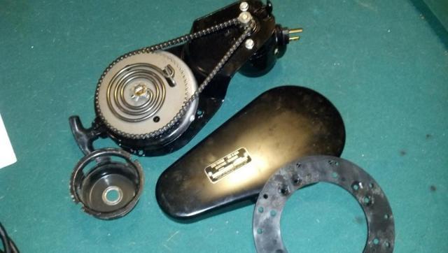

tractornut86 622 #8 Posted May 29, 2013 Yea what you have is a electric start that was optional for a 401.. My 401 has one and i also found a new old stock one in the box..Your best bet is to find another recoil b/c you wont be able to find parts. 2 Share this post Link to post Share on other sites
Boombastic86 0 #9 Posted May 29, 2013 So far I've been having trouble just looking for a recoil in general as most everything I've seen online says it's been discontinued. Any routes of going about fixing this? I grabbed some of the parts from an old Briggs recoil but it doesn't solve the entire problem. Best way for me to fix it I think is to outright replace the recoil with a new (or new to me) unit. Share this post Link to post Share on other sites

VinsRJ 724 #14 Posted May 29, 2013 (edited) Really nice fine, any Kohler K90-91 recoil will work, just make sure you ahve the correct starter cup for the crank. Even a later model Techumseh recoil and cup will work. Edited May 29, 2013 by VinsRJ Share this post Link to post Share on other sites
tractornut86 622 #15 Posted May 29, 2013 Just like VinsRJ said recoils to fit are pretty common but the problem i run into is finding the right cup. either they are to long, to short, or different size hole and pain to get it centered. the correct vintage is a Fairbanks Morse recoil. if nothing else i have some nos rope starts to fit. Share this post Link to post Share on other sites
