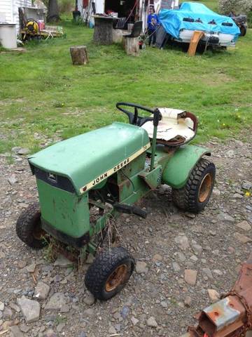

littleredrider 409 #1 Posted May 28, 2013 Anybody have one?? I picked one up this weekend, and need some info and possibly some parts. There is no motor, and from what I've been reading, they are specific to this tractor. I'd like to put a mower deck on it, found one, but the guess the PTO's on these keep from swapping engines easy. Leave it to John Deere. Share this post Link to post Share on other sites
rydogg 186 #2 Posted May 28, 2013 My father has the JD 60 which is the 6hp version yours should have a 7hp vertical shaft tecumseh. Some of these had a "2 speed" rear end you had to flip the seat and fenders back and move the drive belt over to a different size pulley. Share this post Link to post Share on other sites
littleredrider 409 #3 Posted May 28, 2013 This one is a 74, and only the 60s had that two speed rear. Trying to find the pulley and clutch so I can get a motor in there and maybe the mower deck...Can't find anything online, JD doesn't give anything out. Share this post Link to post Share on other sites
