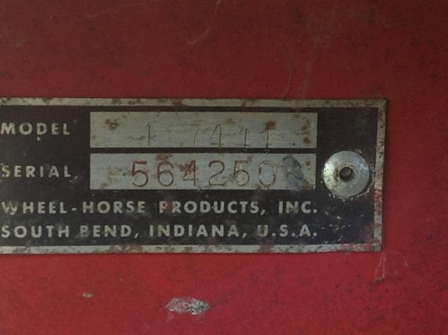

papaglide 542 #7 Posted May 27, 2013 Model. 1-7411 Serial. 564250 Share this post Link to post Share on other sites
squonk 46,177 #8 Posted May 27, 2013 (edited) I found the chart and see that no.s 7473 which is 82'long and 7478 which is 84" long are listed for some 69 tractors. I bet that 82 incher would work.1-7411 is the same model I had. I didn't ever need a belt for it though. Edited May 27, 2013 by squonk Share this post Link to post Share on other sites
papaglide 542 #9 Posted May 27, 2013 That makes sense Mike, thanks. This 85 had so much slack in it that even with the parking brake off I could pull the belt off of the engine pulley! Have to get an 82" tomorrow. Share this post Link to post Share on other sites
tkol1969 92 #10 Posted May 27, 2013 actually model 1-7441? just checking Share this post Link to post Share on other sites
papaglide 542 #11 Posted May 27, 2013 Nope, its stamped 7-411. Share this post Link to post Share on other sites
tkol1969 92 #12 Posted May 27, 2013 model # for 69 gt 14 is 1-7441 according to my owners manual and all years wheelhorse excel file. looking closely at your pic i believe the second 4 isnt stamped very good. just dont want ya to have bad info. Share this post Link to post Share on other sites
squonk 46,177 #13 Posted May 27, 2013 Yes. That's a 4 Share this post Link to post Share on other sites

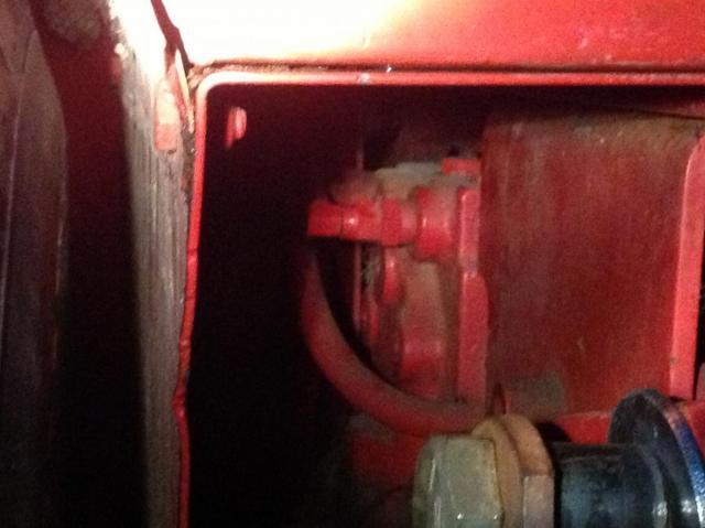

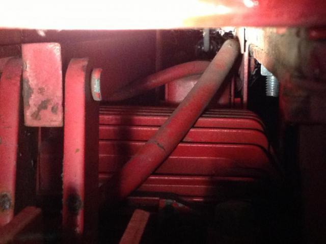

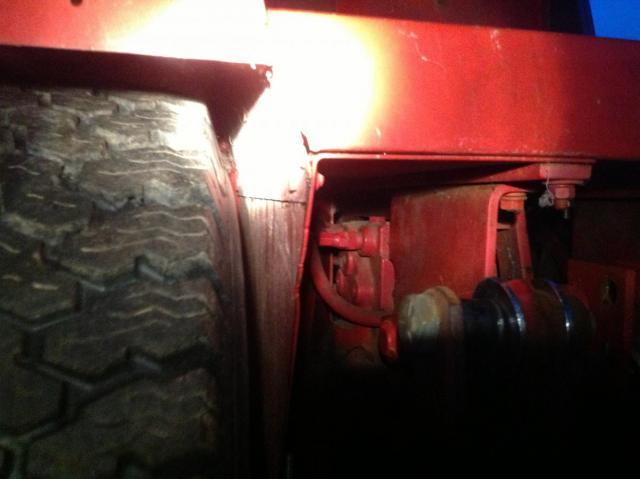

papaglide 542 #15 Posted May 28, 2013 I had the pulley over the belt. One other thing, the "towing valve" which according to my manual should be on the left top of the pump isn't there. I am not quite sure what is up with this tractor, or better yet how much it has been messed with. The hyd lines in the manual look like they come out the top of the pump yet on mine they are coming out of the left side of the pump. Sorry for the bad pics. Share this post Link to post Share on other sites
