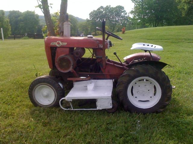

slyacer 3 #1 Posted May 27, 2013 ive got a 701 that i traded a really good mowing whites gt 1855 to. the deck speed on the 701 is super slow compared to a regular riding mower. is it supposed to be that way? i mean on a regular mower the deck is made for smooth finish mowing the deck and blades of this 701 reminds me of a bush hawg. it doesnt have near the speed of a riding mower deck and doesnt cut half as smooth. the only way i can get a smooth cut is in first gear with the deck up top. a good mower should be able to be lowered down and still not bog out and cut. if i get into grass over ankle high it completely stops the deck because the blades dont turn super fast like a good regular riding mower. any tips to correct this problem? ive put all new belts.....sharpened the blades....greased the gears.....everything works like new....but just is slow. is the fact that the deck blades are gear driven instead of belt and bearing the reason that its slow? and if so doesnt that mean if i change and put much bigger pulleys as to make the deck faster ...the gears will fail because they cant take the extra speed? im beginning to think as far as mowers go i messed up in the trade....i figured that along with the power of a little tractor...i would have a tractor that mowed as fast and as smooth as a regular riding mower the way it is....my little murry 12.5hp 38 inch cut mower mows circles around this 701. if thats the best as it gets on the speed of the 701 i may put it up for sale or trade soon because i want a good smooth fast cutting finish mower. thanks guys Share this post Link to post Share on other sites

wallfish 20,677 #3 Posted May 27, 2013 The reason it turns slow is because it's from 1961. The 1961 blades of your 701 do turn much slower than the modern mowers do. I use a 702 in 2nd gear to cut my lawn and it does a nice clean finish mow but my lawn is no where near as big as the field in your pic. It will do an OK job in 3rd gear and even better when the blades are sharp. It sounds like you may need a more modern mower to get the job done quicker rather than looking cool doing it on a 701. Comparing that 50 year old tractor's deck to a modern one is not really apples to apples. Share this post Link to post Share on other sites

slyacer 3 #11 Posted May 28, 2013 ill try another new set of belts...i put all new ones on last week when i got the tractor..put new springs...(even doubled them) the belts play a tune when you pluck them with your finger....and when they bog up with grass the blades stop and the engine bogs down..so i raise the deck to its highest and back up to loosen the grass from the blades...you can see in the pictures thats what my grass looks like all the time......its not even ankle tall....ill figure out the problem or get a new mower just for mowing and leave the WH for a look pretty Share this post Link to post Share on other sites

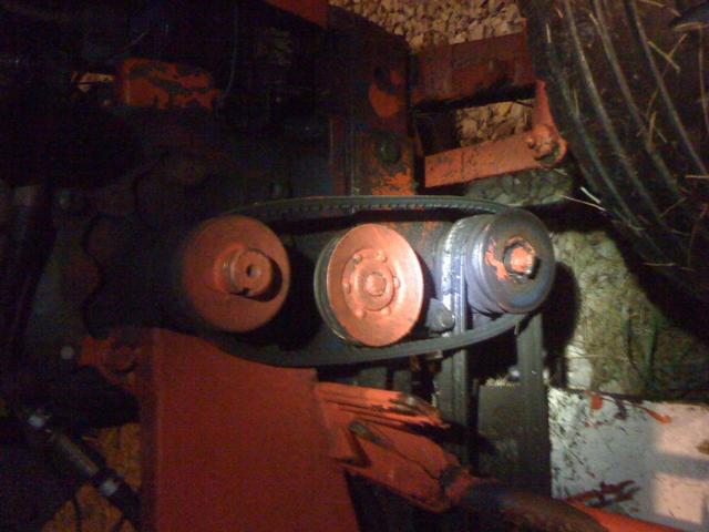

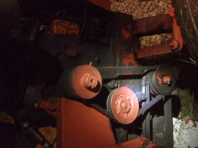

wallfish 20,677 #13 Posted May 28, 2013 That Kentucky blue grass must be tough stuff. Is the back of your deck completely open? It should be. The original design of the deck has a completely open front and rear with the sides there to protect your fingers and toes. Not really any reason it should clog up or need the sides cut out. It should be shooting the grass clippings out of the back. Any chance you can post some better pics of the belt and pulleys at the engine to the deck? It's hard to see in your first pic but the belt looks like it's on the wrong side of the engagement pulley. Maybe some pics of that deck too. Share this post Link to post Share on other sites

slyacer 3 #15 Posted May 29, 2013 these are pics of disengaged and then engaged ill try to get the horse front end up tomorrow to take pics of the under deck and blades but i did make sure to orient the blades with the rotation of the spindles.....to make sure the sharp edges are in the diraction of turn Share this post Link to post Share on other sites
wallfish 20,677 #16 Posted May 29, 2013 That's what it should do, just like you have it is right. Share this post Link to post Share on other sites
CasualObserver 3,417 #17 Posted May 29, 2013 But I'm pretty sure its not supposed to be a cogged belt. Those are used typically in variable speed setups where slippage is required. Try a regular belt. It will work better. via Tapatalk Share this post Link to post Share on other sites

SousaKerry 503 #19 Posted June 5, 2013 My 2 cents... Ditch the belt and get a Wheel Horse original equipment belt. Also did you use a matched pair of Wheel Horse belts on the deck? If not that will make a huge difference also. Those belt salesmen will tell you anything and show you all kinds of skewed data to prove their point and sell their belt. But the simple fact is that WH designed this equipment in the 60's to be used with their own belts. Modern belts are designed to be used on modern equipment with different belt angles belt widths in the pullies. The toothed belts do not have as much surface area on the sides where they make contact with the pulley. This is fine when your belt is overrated for the load, not so much when your load is at the upper limit of the power rating. In a solid belt when the belt goes around a pulley the rubber has to compress and become wider thus biting into the pulley better (one of the theories behind minimum belt wrap) a toothed belt does not do this as there is no material there to compress. Share this post Link to post Share on other sites
