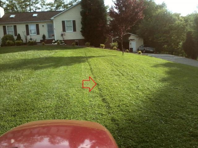

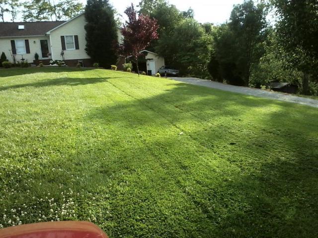

Torino 15 #1 Posted May 26, 2013 520xi 48" 78363 deck. As the pics show I am getting strips on my lawn especially if it is uneven or going around a corner. If it is nice and flat it does good. I have set the deck wheels a couple times trying to get it to stop. Any thoughts? Share this post Link to post Share on other sites

Torino 15 #8 Posted May 27, 2013 Let me make sure we are all on the same page. I am referring to the strip pointed at in below photo. This is about the 4th time I have mowed with this tractor. It is happening on the edge of the deck. Share this post Link to post Share on other sites
