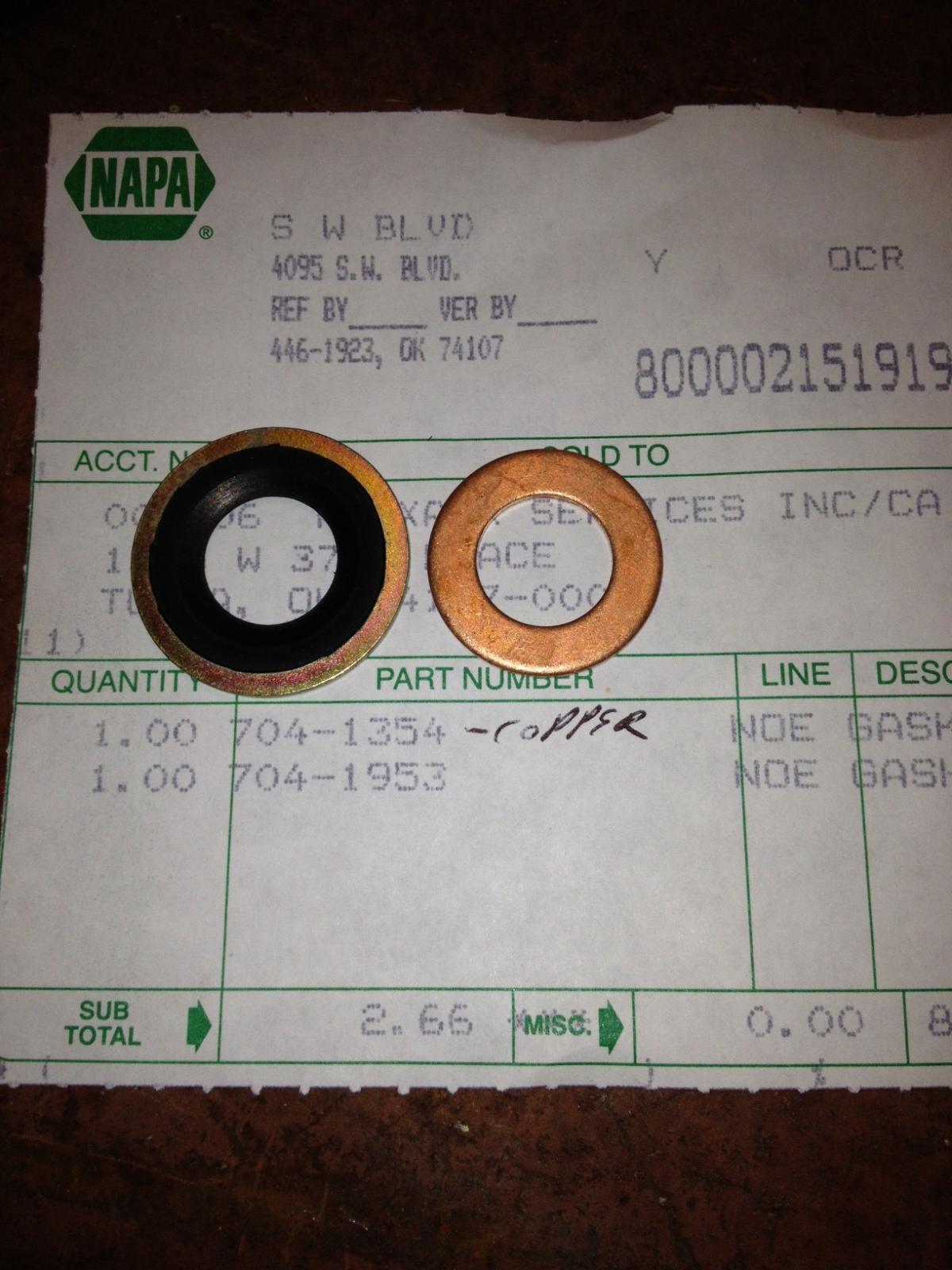

brandonozz 168 #1 Posted May 22, 2013 I know there has been some discussion about the NLA copper gasket on the front 1/2" bolt on the mannifold D series. Just thought I would post a part number for a copper gasket I found at Napa. There is a sealing gasket that is close but I installed the copper gasket as it was a perfect fit. Part numbers are on the receipt. 1 Share this post Link to post Share on other sites

gwest_ca-(File Mod) 12,519 #3 Posted May 22, 2013 I know there has been some discussion about the NLA copper gasket on the front 1/2" bolt on the mannifold D series. Just thought I would post a part number for a copper gasket I found at Napa. There is a sealing gasket that is close but I installed the copper gasket as it was a perfect fit. Part numbers are on the receipt. Does this gasket have a Wheel Horse part number? Would help in future searches. Garry Share this post Link to post Share on other sites
JamesBe1 84 #4 Posted May 23, 2013 Nice find Brandon. As an extra added bonus, the other washers that work are PN: 750-0002-1/2 from McMaster-Carr. Just thought I'd share that, I'm not trying to steal your thread. j Share this post Link to post Share on other sites
brandonozz 168 #5 Posted May 23, 2013 Nice find Brandon. As an extra added bonus, the other washers that work are PN: 750-0002-1/2 from McMaster-Carr. Just thought I'd share that, I'm not trying to steal your thread. j Steal my thread? no worries... all information is good information. I'm not familiar with McMaster down here - I think Fastenal may be a compariable type store. I just figured that Napa was almost everywhere, even many small towns. The other nice thing is that they sold me one - not a bag. Them copper washers aren't cheep....well for a washer! Garry, part number is 4-67 on the Toro parts viewer on the transmission diagram - part 102817 it's the "seal-manniford bolt". Andy, I'm with you on searching for information on D's. Getting a 200 going that's been sitting for 6 years and never seeing one before I've been doing a lot of searches! By the way, is there a Napa store over the pond? Share this post Link to post Share on other sites
