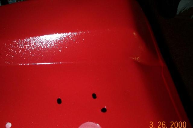

Ok guys, I am totaly depressed. painted the hood & rear pan, looks great from a distance BUT up close it looks like a RED ORANGE.
What did I do wrong???
Ya, I know I got to sand her down. But what caused it ???

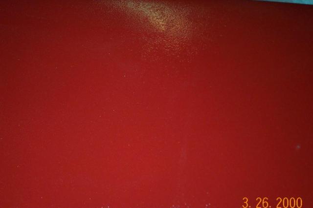

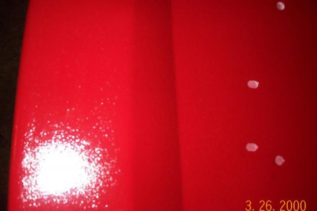

Well, here the pic's I didn't want to take, but you guys wanted them.
Yes it is from a rattle can, Rustolium Reagel Red and she was primed and sanded and whiped with denatured alcohol.
68 degrees and low humidty.post-9868-0-08943600-1369149153_thumb.jppost-9868-0-23753500-1369149159_thumb.jppost-9868-0-80473500-1369149168_thumb.jp

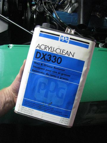

  Not seeing it in person, that looks like what is called fish eye, the surface had something on it, like a oil of some kind, I use a wax a grease remover made for paint prep, about $13 a gal. at most auto parts stores, from here it looks like time to start over. did your first coat go on with little spots that the paint did not stick to? little tiny dots all over??
Contaminates on the surface caused your fisheye problem...try again using the proper cleaner.  :handgestures-thumbsup:
post-3498-0-41163400-1369167377_thumb.jp
KC9KAS
Not to steal the thread, but once a friend painted a VW Beetle. It was totally orange peel, and the color was Orange! I thought it looked great, but the owner wanted it fixed!
Kelly
Yup something like Craig posted, I use the cheaper house brand but pretty much the same stuff.

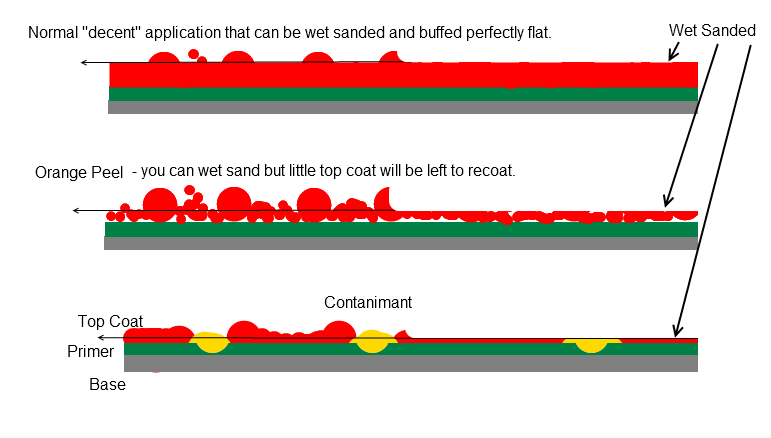

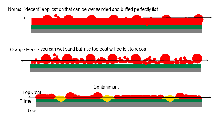

orange peel and a really bad case of fisheye may look similar - usually fish eye is seen in just a few small spots over a project where as orange peel is a function of improper gun / paint performance. True fisheye is improper surface prep and usually results in "craters" in the paint. The bottom of these craters usually show the surface you sprayed on. Wet sanding would have to be done almost down to the surface to remove a true fish eye defect. Orange peel can be corrected by wet sand whereas the paint near a fish eye usually has to be taken down to the surface and feather edged into the remainder of the paint job.
My own experience with true fish eye vs true orange peel suggests a cross section of the defects would look something like the diagram below. The yellow contaminant will usually "push away" the top coat and refuses to meld with it. The result is a true crater or fish eye vs a rough orange peel surface.
