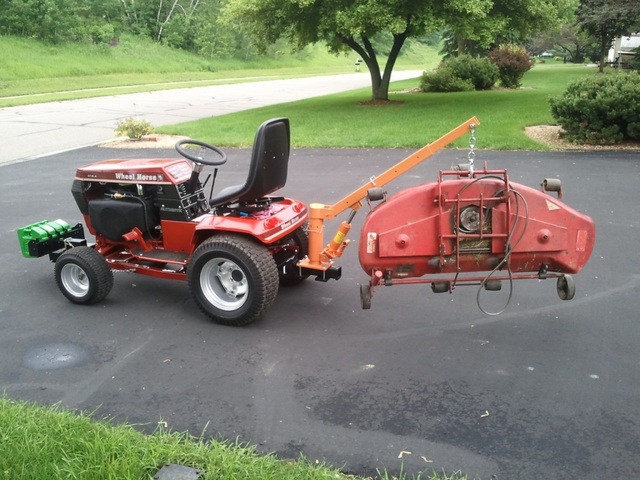

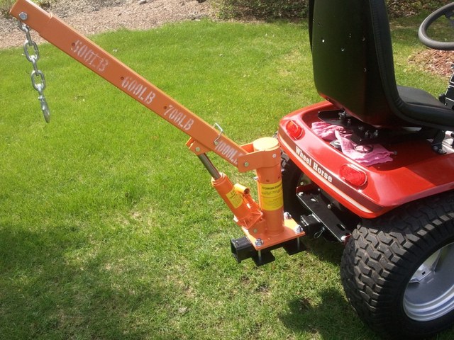

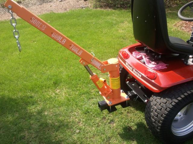

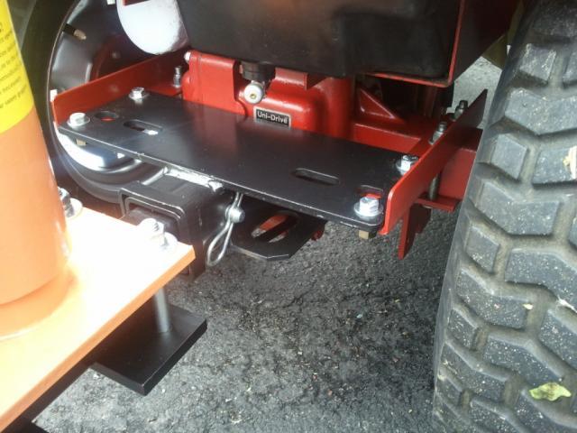

Catt 13 #1 Posted May 19, 2013 I bought a pickup truck crane and plan to use it on my 418-A to move docks at the cabin. I added a rear 2" receiver and mounted the crane to a receiver extension so it can be easily removed. The receiver is attached to a tiller mount and also has bracing to the old hitch mount on the lower portion of the axle. Seems pretty strong. 4 Share this post Link to post Share on other sites

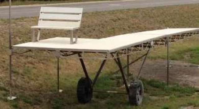

Catt 13 #5 Posted May 19, 2013 This is an example of one of the docks that I put in the lake. It's aluminum and has wheels out in the water and although it isn't extremely heavy, it's still a job with one person. It goes in the lake once in spring and out in the fall. You're right about front weight. I have suitcase weights ready and will likely be adding weight to the front. Share this post Link to post Share on other sites

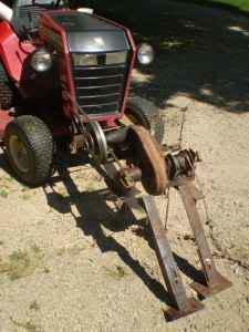

Don1977 606 #10 Posted May 20, 2013 Check out this weight bracket: Here is my front bumper it's not a weight bracket. I found that by putting 1/2" spacers behind the bars that it will allow room the mule drive. Share this post Link to post Share on other sites

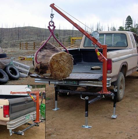

fireman 1,022 #11 Posted May 20, 2013 One of two things are going to happen when you go to lift something of substantial weight. Those two pieces of red angle iron that mount the hitch are gonna bend like a cheap suit with all the torque that will be applied or the front end will lift or flip as the fulcrum is at the axle. I would suggest adding a crank down jack of some type right at the base of the crane to give it some stability. Something along these lines for example: 2 Share this post Link to post Share on other sites
stevebo-(Moderator) 8,742 #12 Posted May 20, 2013 Fireman makes a good point here. Only issue is I think he wants it to be mobile.... Maybe something with a wheel. Maybe a wheelie bar coming off the boom? Share this post Link to post Share on other sites
fireman 1,022 #13 Posted May 20, 2013 I re-read his original post and see that he did add bracing to the original hitch so that may be ok. Using it in a mobile application I would definitely add a ton of weigh to the front end. Share this post Link to post Share on other sites
squonk 48,228 #14 Posted May 20, 2013 Don't forget the stress on the frame where the trans bolts on. Major weak point on 's 1 Share this post Link to post Share on other sites

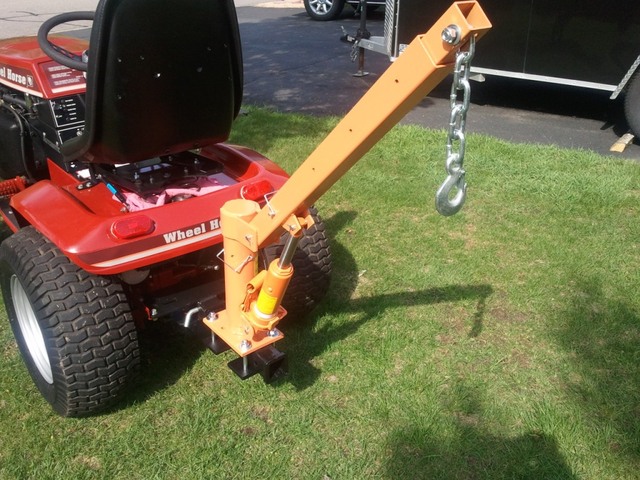

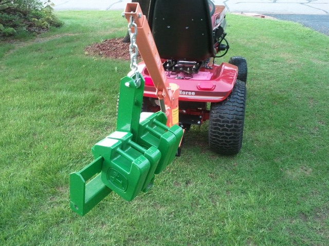

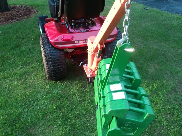

Catt 13 #15 Posted May 20, 2013 Those are great ideas! I hadn't really considered anything heavier than docks, but a couple wheels and jacks would certainly be interesting. Regarding the receiver hitch... The angle iron is primarily for pulling, but does offer limited torsional strength. What you can't see is the additional supports on the bottom of the hitch that attach to the axle (I couldn't get good pictures of those supports). I've done testing and am pretty confident it will lift a dock (but there is always Murphy's law). The first picture is of a dead lift off the ground with no additional front weight (but it's needed!). The suit case weights are from another of my tractors and weigh 40 lbs each. The 3 point hitch bracket weighs around 50 lbs. Total weight 210 lbs. In the second picture I added two additional 40 lbs weights, but I couldn't do a dead lift and keep the front of the tractor down even though I added 40 lbs. Total 290 lbs. The third picture shows if there is any angle iron deflection with 290 lbs. I'm expecting the dock to not be more than 150 lbs. Share this post Link to post Share on other sites

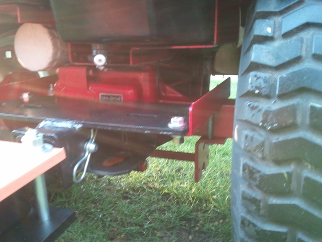

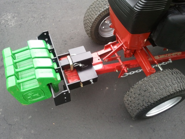

Catt 13 #20 Posted June 9, 2013 I purchased a snow plow that was made for a newer Toro / Wheel Horse. Removed the plow and used the frame to make a receiver hitch for the front. It has a lift mount near the front of the frame and I also added the hydraulic lift near the middle of the frame. I have a second set of rims coming and lug tires. Will also brace the frame. Here are a couple pictures of the progress I've made. Pardon the green! 5 1 Share this post Link to post Share on other sites
