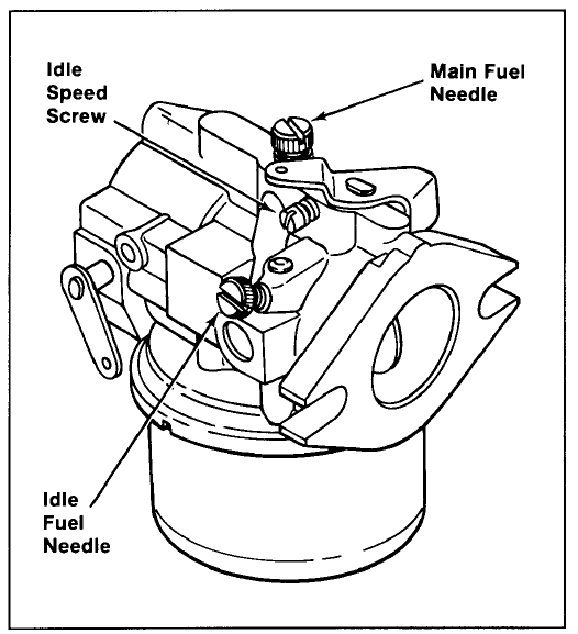

gcole 36 #1 Posted May 13, 2013 Hi guys I finally got a kohler in my c-120. Now that I got it home the engine just dosnt want to run right. It spits and spudders and spits gas out the carb on rev up. But it seems to idle good lol. Anywasys if anyone has a step by step list of what to do to get her running good I would be greatly thankful Thanks in advance. Graham Share this post Link to post Share on other sites

gcole 36 #5 Posted May 14, 2013 Thanks for the replies guys. I had a chance tonight and readjusted the points as I already did today and it ran a whole lot better. With a little more carb toon I think I'll have her beat. Speaking of that how many turns out from the bottom do I turn the low and high idle and what's the smaller screw Inbetween the two? Thanks in advance Share this post Link to post Share on other sites
WH nut 553 #6 Posted May 14, 2013 Thefre is no set adjustment for the carb. There is a starting point to get it running, but after that you adjust to get her dialed in. Adjust the high speed no load is turn in until it starts to run rough, back out until it starts to run rough then turn in until she smooths out. Share this post Link to post Share on other sites
rmaynard 17,642 #7 Posted May 14, 2013 (edited) ...how many turns out from the bottom do I turn the low and high idle and what's the smaller screw in between the two? Go to section 6, page 6.4 of your Kohler manual, and you will find the initial settings for your carburetor. For the K301 it is LOW IDLE 2-1/2, HIGH IDLE 2. If you have a Walbro carburetor the only adjustment is the LOW IDLE 1-1/4 turns. If you don't have a manual you can download it from the manuals section of the forum. http://www.wheelhorseforum.com/files/file/674-kohler-k-series-sm-tp-2379pdf/ Edited May 14, 2013 by rmaynard Share this post Link to post Share on other sites
