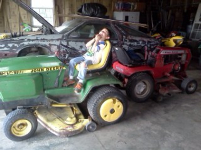

Horse Lover310 3 #1 Posted May 12, 2013 Picked up this 1983 Deere 314 for $220 today. I'm not much of a JD but I couldn't pass it up for a spare in case something happens to my 310-8. He said that he can't get it to start. It had zero compression so I pulled the head off the 14 kohler. Found the intake valve never hits the seat. I got lucky on this one, no wear on the bore either. Might need a cam since it was always had spring pressure on the lifter and cam. 1 Share this post Link to post Share on other sites

Horse Lover310 3 #7 Posted May 13, 2013 All I have found so far is it needs the intake valve and maybe a valve seat. It's hard to work on it cause my 2 boys keep fighting over who gets to sit on it. Boys will be boys. Share this post Link to post Share on other sites

Horse Lover310 3 #9 Posted May 29, 2013 It started yesterday. New intake valve and rotator. The carb needs a throttle shaft bushing, it's pretty sloppy and a new set of points. Moves forward and backwards so it's not too bad. Share this post Link to post Share on other sites
