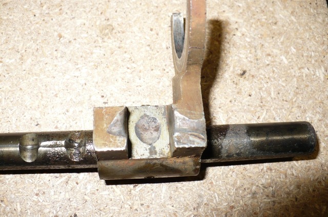

stevasaurus 23,860 #11 Posted May 19, 2013 Can you post some pictures of what you have...?? That would help us a lot to know what the damage is...and where we need to go to help you get it back together. Share this post Link to post Share on other sites

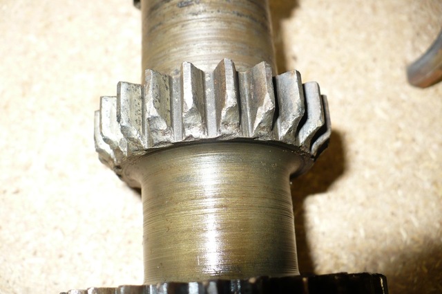

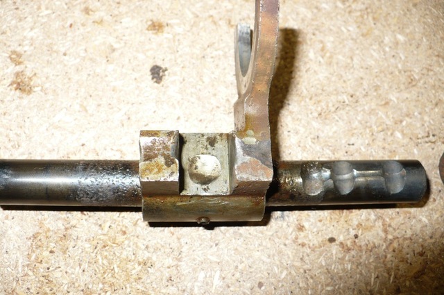

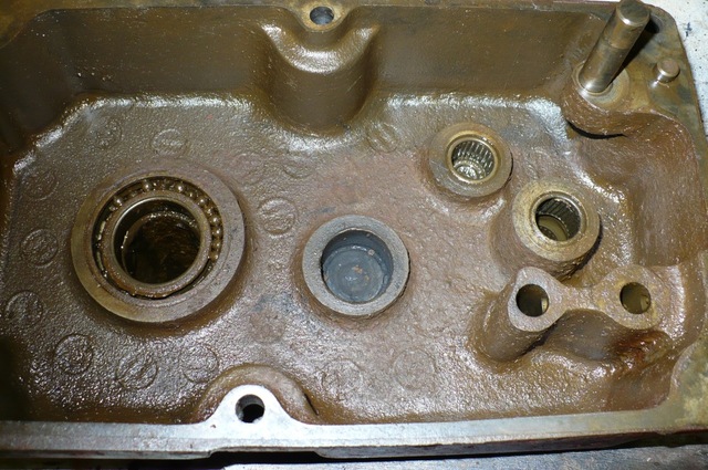

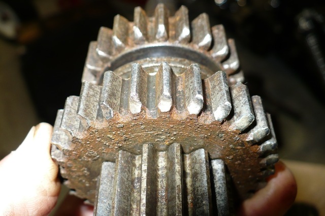

tracer 3 #12 Posted May 20, 2013 Here the first 4 pictures. Share this post Link to post Share on other sites

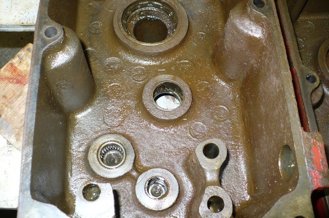

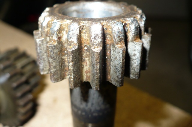

tracer 3 #13 Posted May 20, 2013 And the last 3 pictures. Share this post Link to post Share on other sites
stevasaurus 23,860 #14 Posted May 20, 2013 Great pictures... Got some damage in there, but it is not that bad. Those forks and shafts look OK, just need to clean up a couple of those notches a little.where the detente balls work. Your input shaft looks worse then it really is. You could use a new cluster gear. That 1st/rev fork gear is OK depending on what you are going to use the horse for when you put it back together. Mowing, moving snow should be OK...plowing dirt, maybe not. Your 2nd/3rd fork gear looks good on the out side...take a good look at how it fits on the input shaft. If it is a sloppy or bad fit, that is when the trans will pop out of 3rd gear. Great job so far...thanks for the pictures. Share this post Link to post Share on other sites

Coadster32 793 #17 Posted May 23, 2013 You also might consider a full tranny swap as well, depending on what you find for parts. Looks like the bearing in the first picture is missing a few balls as well. Like Steve said, the gears, and shafts aren't as bad as you might think from first glance. You might want to take a look at the bottom of the shifter shaft as well. That could be worn a bit as well. BTW-- Pretty cool to see you diving right into it. 1 Share this post Link to post Share on other sites
Jeff-C175 7,211 #18 Posted May 23, 2013 In the very first pic, right in the center... there's what appears to be the remains of a needle roller bearing, it looks 'gray' in the hole. The needle roller is gone... is that bore egg shaped? Looks like it in the photo? Share this post Link to post Share on other sites
stevasaurus 23,860 #19 Posted May 23, 2013 It is not egg shaped...that is the just the drilling for the bearing through the casting. That is one of the capped bearings...the needles are gone and the housing is still in there in the picture. It just needs to be tapped out. Share this post Link to post Share on other sites
