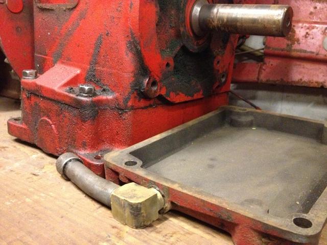

Martin 2,134 #4 Posted May 10, 2013 (edited) the k241 is a small base engine with a low height oil pan to be able to fit the engine under the hood...... the small base engine doesnt have the 'ears' that the larger oil pan bolts to. a special short dipper connecting rod is needed as well. there are other differences too, but these are the main 'engine' ones........ normal wheel horse spec pan on a large base engine on the left and a low height pan next to it. i see the kiwi beat me to it while i was out in the garage with the camera..... Edited May 10, 2013 by Martin 1 Share this post Link to post Share on other sites
Fordiesel69 272 #5 Posted May 10, 2013 Thanks, looks super rare then..... Looks like a regular one won;t work. Oh well. I wonder if it is a special dipper, or if it can just be ground down a bit. Share this post Link to post Share on other sites
Martin 2,134 #6 Posted May 10, 2013 (edited) If you have a shallow pan and one of the c series isolator engines (or any small base kohler big block k for that matter) you could put one together. I have read on here that members have cut down the dipper to fit the shallow pan before. I don't think it would be too difficult to measure the length....... Just remember measure twice, cut once. Cut it too short and you will have no 'splash' I got the shallow pan to do one myself, just too many other projects on the go........ Sent from my iPhone using Tapatalk Edited May 10, 2013 by Martin Share this post Link to post Share on other sites
