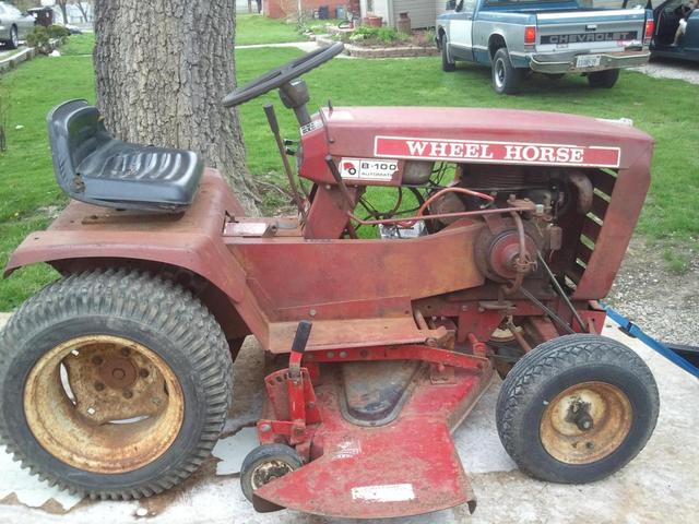

Bulldemis 2 #1 Posted April 30, 2013 I am a new member and would like to introduce myself. My name is John and I live in Manito, IL. This is my first Wheelhorse. I just purchased a 1975 B-100 automatic. It is in decent running condition but I can see some work that will need done. It will need totally rewired and does not have a voltage regulator. It looks as though the filter for the transaxle has not been changed in quite some time if ever. What filter does it take? I have a set of wider 5 bolt wheels and tires off of a Cub Cadet They are 23X8.5X12. Will these fit? Thanks in advance for any help you can give. 2 Share this post Link to post Share on other sites

posifour11 723 #3 Posted April 30, 2013 Filter should be Napa# 1410 Share this post Link to post Share on other sites
WH854 45 #4 Posted April 30, 2013 I am a new member and would like to introduce myself. My name is John and I live in Manito, IL. This is my first Wheelhorse. I just purchased a 1975 B-100 automatic. It is in decent running condition but I can see some work that will need done. It will need totally rewired and does not have a voltage regulator. It looks as though the filter for the transaxle has not been changed in quite some time if ever. What filter does it take? I have a set of wider 5 bolt wheels and tires off of a Cub Cadet They are 23X8.5X12. Will these fit? Thanks in advance for any help you can give. Model#(1-0511) 1975 B-100 Auto you can put that model# here will give you a part break down of the tractor. https://lookup3.toro.com/partdex/index.cfm?xCaller=Toro Chas Share this post Link to post Share on other sites
chrisd200(inactive) 56 #5 Posted April 30, 2013 Welcome to Red Square!!!!!!!!!!!!!!!!!!!!!!!!!!!!!!!!!!!!!!!!! Dont know about the cub wheels but your Hydro filter should be a toro # 102819 that I think changes to a # 79-5270 Good luck getting the old horse going. Nice little tractor! Share this post Link to post Share on other sites
Bulldemis 2 #6 Posted April 30, 2013 Thanks for the warm welcome! Does anyone know if this takes a special blade? I'm talking about the one that looks like a snow plow. I am going to get some top soil delivered for my garden. I have seen several different tractors with blades and I see some listed near me. I think it would be handy to move the dirt around. As far as the wheels I will be answering my own question tomorrow and just put them on and see how they look. They are a little taller and quite a bit wider than the ones that are currently on there. Before I do anything as far as using it I am going to change all of the fluids and filters. I see Vinylguy has aftermarket decals for the tractor. If I get around to painting it I will be giving you a call. Share this post Link to post Share on other sites
Bulldemis 2 #7 Posted May 2, 2013 Well to answer my own question the larger tires do fit. There is not much room on the inside but it does not rub. Share this post Link to post Share on other sites

Bulldemis 2 #9 Posted May 2, 2013 I have it running but it runs very rough. It sounds like an old hit and miss engine. I am going to do the typical, new points, condensor, coil, and clean the carburator. Share this post Link to post Share on other sites
stevasaurus 23,826 #10 Posted May 2, 2013 (edited) Welcome to Red Square fellow Illini...nice horse. The dozer blade that fits is # 6-2132 (a # 6-2131 should also fit) and should be in the $50-$75 range. This blade fits any "B" and "C" series...I had to turn the handle that angles the blade around and redo the wire puller to fit through the space in front of the foot panel on the right side to clear the brake pedal and PTO. Edited May 2, 2013 by stevasaurus Share this post Link to post Share on other sites
