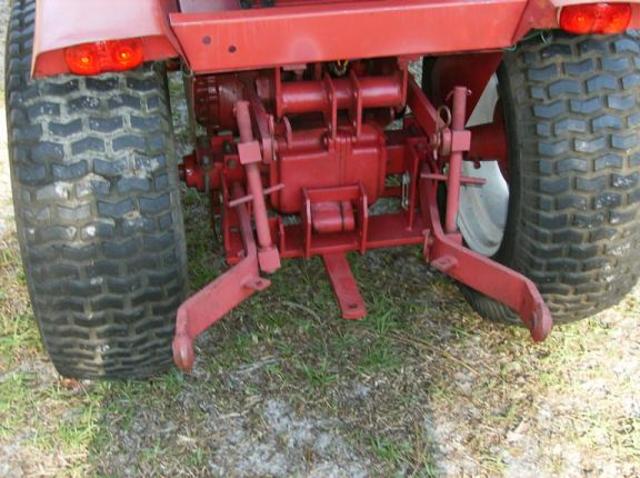

tkol1969 92 #5 Posted May 1, 2013 dug up this old pic i found online. things arent hooked up right but you get the idea. actually the bottom limks have two hookup holes on each side at different heights. if i can tomorrow i will try and measure mine for ya. looks like the top hole is about at the bottom of the axel and the other below that. talk to ya soon Share this post Link to post Share on other sites

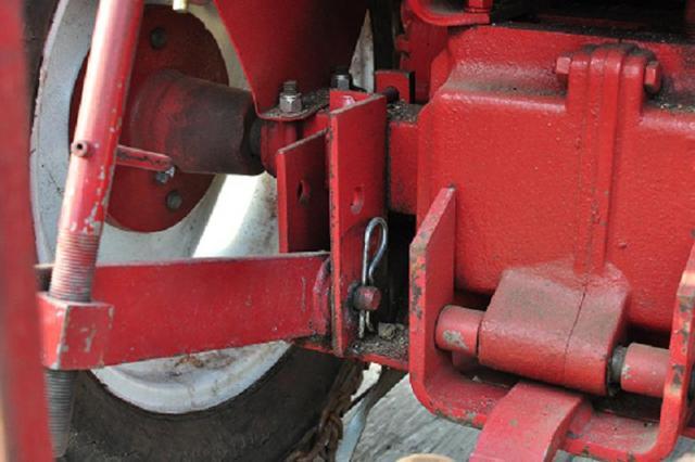

tkol1969 92 #11 Posted May 25, 2013 sorry i have'nt forgot about ya. things have been pretty busy. well i was doing some work and didnt have a tape measure but my buddy had a camera, got ya some better pics. you can probably figure it out from thes. ill still try and get exact measurement today. on mine i think i incorporated the plow hookup right to the 3 point somehow? don't remember exactly why Share this post Link to post Share on other sites
sned 15 #12 Posted May 26, 2013 Thanks tkol it looks like basically a c-channel bolted to the back of the plow bracket. From what I can tell there are two mount holes. One level with axle and one lower even with the hitch bolt. I think I can wing it from here. Here we go! Share this post Link to post Share on other sites
tkol1969 92 #13 Posted May 26, 2013 yeah the bottom of the top hole is level with the bottom of the axle and the lower hole is 2.5 inches down. bolts to the axle like plow mount and thats why i welded plow bracket to it. actually u bolts are in the same place as plow u bolts. coundnt have both so thats what i did. Share this post Link to post Share on other sites
