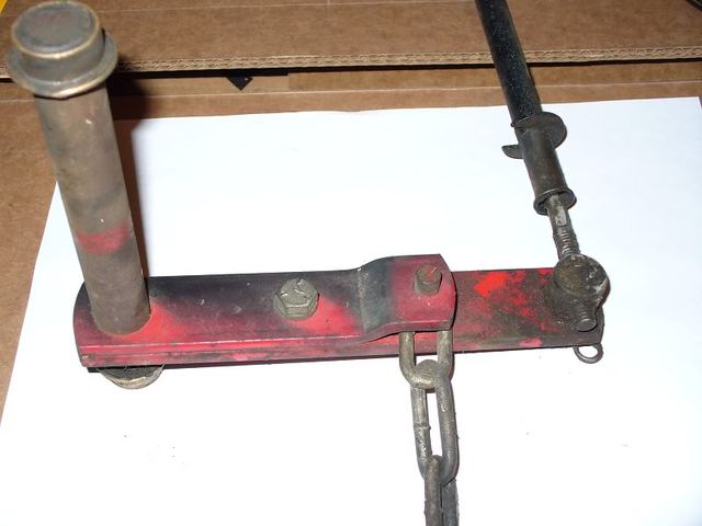

Tom. 70 #6 Posted April 30, 2013 Hi all, I have been out this afternoon for a bit and I got the seat and fender off and had a good look. It all seems to make sense now and I know exactly what I need to do. I notice Dr Clank didn't use a rock shaft but I think I will be. I have attached a picture of a rock shaft, is that the sort of thing I need? Thanks for all your help so far. Tom Share this post Link to post Share on other sites
meadowfield 3,191 #7 Posted May 1, 2013 that's about right, but the ones I've seen were offset - i.e. hands on a clock (1pm) Share this post Link to post Share on other sites
876wheelhorse 46 #8 Posted August 11, 2013 so this shaft is saving the wear and tear on the lift cylinder? by having this shaft is bringing the shaft back and forth and with having the attachment hooking up a couple inches when load is up it is actually hanging on this shaft and not the cylinder. is this right ? i was just going to run a cable back but after thinking about this this is better way to do right? Share this post Link to post Share on other sites
