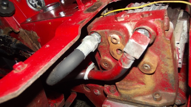

Hatedge 10 #1 Posted April 25, 2013 Ive read in the manual that I should use 10/30 oil in tme C160 trans. I find it odd, I wouldve put 80/90 gear oil in there. But on the hydro part I havent found what type of fluid I sould use. Should I use ATF dextron? And if not what fluid Is the right one and how do I get the fluid level? Second question: On the left hand side of my c160 hydro pump there's a hydraulic hose that comes out and back in. I find that a bit odd. Anyone care to explain this one to me? Share this post Link to post Share on other sites
squonk 45,680 #2 Posted April 25, 2013 Use Mobil 1 10w30 and either a Toro or Napa 1410 filter. The hoses were for hydraulic lift valve. The hoses need to be looped if you have a manual lift. Share this post Link to post Share on other sites
Trouty56 567 #3 Posted April 25, 2013 There are plugs for the tranny but maybe someone took the lift cylinder off (could have been leaking all over the place) and didn't have the plugs so they looped the one hose. Heck the implement hardware might still be in the pump. Doesn't have to be synthetic but the prices are pretty close anymore for high cost dino oil and low cost synthetic. Wallys Mart brand cost only 18 or so bucks for 5 qts. Squonks got it right on the filters..... Share this post Link to post Share on other sites
Hatedge 10 #4 Posted April 25, 2013 There are plugs for the tranny but maybe someone took the lift cylinder off (could have been leaking all over the place) and didn't have the plugs so they looped the one hose. Heck the implement hardware might still be in the pump. Doesn't have to be synthetic but the prices are pretty close anymore for high cost dino oil and low cost synthetic. Wallys Mart brand cost only 18 or so bucks for 5 qts. Squonks got it right on the filters..... Do you mean to tell me that I could hook a body valve and a cylinder to this and get a 3 point or hydraulic lift ? If so I need to hear more details as to how one goes about hookking this up Share this post Link to post Share on other sites

Trouty56 567 #6 Posted April 26, 2013 (edited) There are plugs for the tranny but maybe someone took the lift cylinder off (could have been leaking all over the place) and didn't have the plugs so they looped the one hose. Heck the implement hardware might still be in the pump. Doesn't have to be synthetic but the prices are pretty close anymore for high cost dino oil and low cost synthetic. Wallys Mart brand cost only 18 or so bucks for 5 qts. Squonks got it right on the filters..... Do you mean to tell me that I could hook a body valve and a cylinder to this and get a 3 point or hydraulic lift ? If so I need to hear more details as to how one goes about hookking this up There are plugs for the tranny but maybe someone took the lift cylinder off (could have been leaking all over the place) and didn't have the plugs so they looped the one hose. Heck the implement hardware might still be in the pump. Doesn't have to be synthetic but the prices are pretty close anymore for high cost dino oil and low cost synthetic. Wallys Mart brand cost only 18 or so bucks for 5 qts. Squonks got it right on the filters..... Do you mean to tell me that I could hook a body valve and a cylinder to this and get a 3 point or hydraulic lift ? If so I need to hear more details as to how one goes about hookking this up I need to know more about this too Sent from my 416-8 All the sundstrand hydro's have the implement capability but not all are equipped with the necessary parts to control the flow. If that hardware is not in the pump then the implement lines are plugged from the get go. Since there is a hose on this particular tractor it leads me to believe the necessary hardware may be in the pump. The parts list for a 120 or 160 hydro will show the parts needed. Edited April 26, 2013 by Trouty56 Share this post Link to post Share on other sites
pfrederi 19,992 #7 Posted April 26, 2013 What color is the fluid in there now? Red is ATF (Dexron). Tan is motor oil. Unless you want to completely flush the system stick with what you have...do not mix them. Share this post Link to post Share on other sites
Hatedge 10 #8 Posted April 26, 2013 I check the dipstick under the seat and its tan in color. So I guess that means its engine oil or gear oil in there now. The oil seems clean enough and has good smell. No reason to doubt the right oil has been used I guess. Now, on the C160 I have the lifting system off a parts C120 but the lifting mecanism minus the lever is in a box of random parts that the seller gave me. If im not mistaken the lifting Assy. has a 3rd bracket that falls betwix the frame and the foot rest. That gets me guessing that it used to be a hydro lift in the pas and was modified to receive the gerryrigged lever thats on there now. I do have a hydro cylinder lying around that I could use to get this hydro lift working I think. But im still puzzled at the lack of hydro controls on the tractor though. Theres no trace of them control valves that have been removed. Ill have to double check the manuals. Share this post Link to post Share on other sites

i967mustang 21 #14 Posted October 16, 2013 My C160 has a tag on it that says to use 10-30 motor oil in it. If it had hydraulic lift and it was taken off and a regular lift installed they would have removed the lift control for the manual lift stop. Also they would have had to change the rock shaft. I just finished converting my C160 8 speed to Hydro with hydraulic lift. The lift cyl. goes in between the running board and the frame, the running board gets moved further outboard and has a link in the rear where there is a square hole in the running board. This actually carries the hoses and supports the rear inside of the running board. Share this post Link to post Share on other sites
