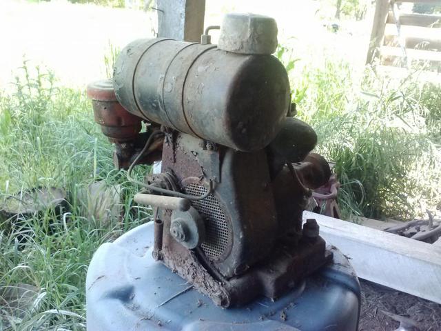

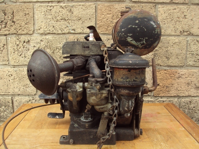

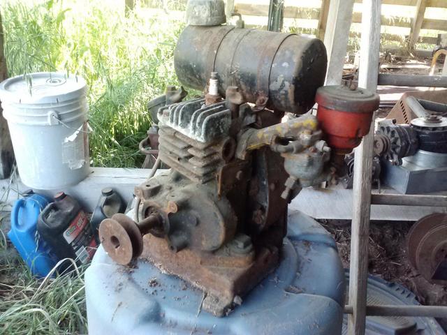

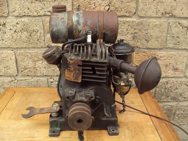

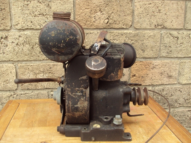

groundhog47 448 #1 Posted April 23, 2013 Gettin' this engine Sun, only know it is hand/crank start, looks like B&S Oil Bath and newer type old B&S intake plumbing, but shroud/cooling and tank look like similar to Clinton. The pipe cap on tank is just to keep falling stuff out. Owner found no markings or ID plates. Share this post Link to post Share on other sites
Sparky-(Admin) 26,368 #2 Posted April 23, 2013 Could it be a Wisconsin? Mike......... Share this post Link to post Share on other sites
russtiron 41 #3 Posted April 23, 2013 (edited) Briggs for sure I think a W series I don`t think the carb is right for this engine,but not sure I think the brass tag would have been on the shroud behind the carburetor. Ask the experts at Harry`s Smokestak site under small engine someone there will know for sure Edited April 23, 2013 by russtiron Share this post Link to post Share on other sites
VinsRJ 724 #4 Posted April 23, 2013 I was thinking a Briggs also. Share this post Link to post Share on other sites
groundhog47 448 #5 Posted April 23, 2013 I did peruse the vintage engine sites and now am leaning toward B&S and as russtiron said carb appears wrong, hopefully can shed more when actually get it 360 viewed also. The nearest example had a sediment bowl beside carb. Thanks guys for your input Share this post Link to post Share on other sites

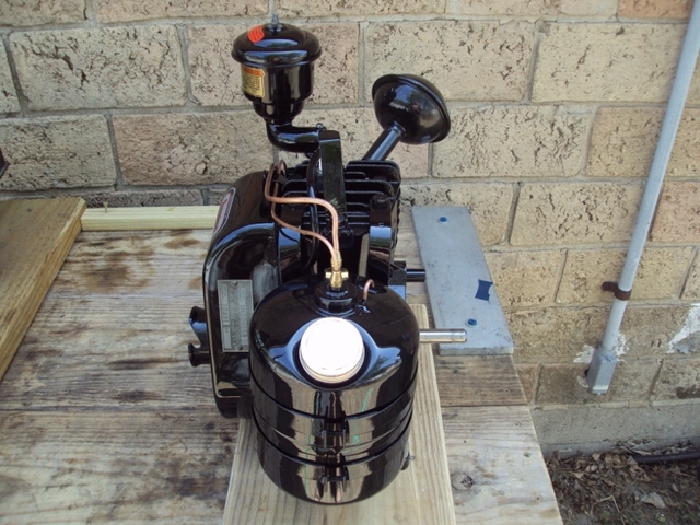

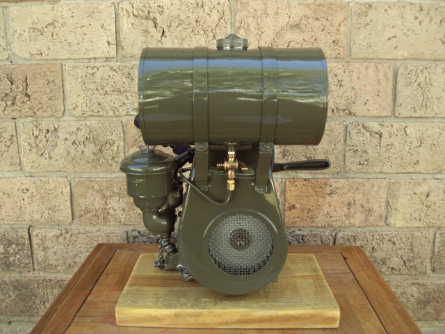

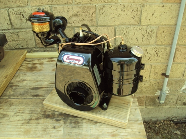

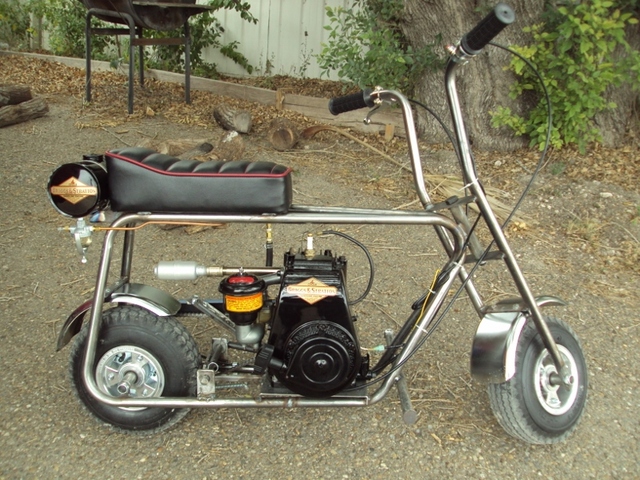

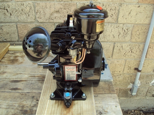

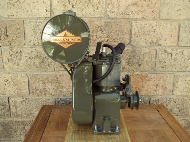

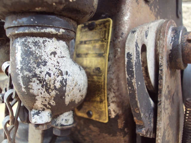

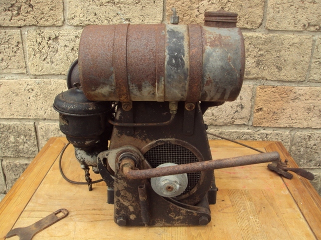

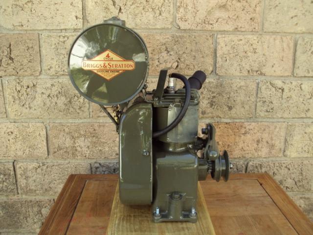

bowtiebutler956 650 #7 Posted May 3, 2013 That is a Briggs Model I, 2in. bore. 1.5in. stroke. That is the wrong carb, and intake. I have this exact same engine. Here are a few pics, and a video. Any questions you have, just ask. Matt http://youtu.be/_8seuvAD3Xo 1 Share this post Link to post Share on other sites
groundhog47 448 #8 Posted May 3, 2013 That's it, and thanks for video, Been tryin this one reverse, sumpin wrong where won't disengage at top of pull. Appears some sort of cluthin effect between crank mag gear and crank must be inop. At anyrate, thanks for your input! Share this post Link to post Share on other sites

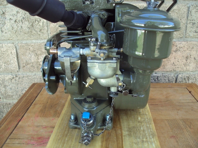

bowtiebutler956 650 #9 Posted May 3, 2013 That's it, and thanks for video, Been tryin this one reverse, sumpin wrong where won't disengage at top of pull. Appears some sort of cluthin effect between crank mag gear and crank must be inop. At anyrate, thanks for your input! The problem your having with the start lever not disengaging is a simple fix. Its just the aluminum engage clutch there on the front of the engine. Remove the allen head set screw, and pull the clutch off. On the back of the clutch is an internal snap ring, remove it and clean the the inside of the clutch. There are 4 5/16 steel balls in it, that have just gotten dirty over the years. Clean it up, and make sure to assemble it dry, no lubrication, as it would lead to them getting gumed up again. Most the time this is all thats ever wrong with these old Briggs start clutches. Once in awhile, I run into one where the balls are excessively worn or rusty, in which case I just pick up some new 5/16 steel balls, and it as good as new. The carb, and intake you need were also used on the Briggs model N, and they come up on ebay very frequentley. The carb part no. is #99876 Matt 1 Share this post Link to post Share on other sites

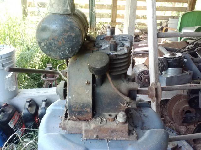

groundhog47 448 #10 Posted May 4, 2013 Matt, it may be I should leave it to abler hands. the handle spring is there and broken, I figd it must go against spring tension but couldn't get it to work. You make the start look so easy in video. Hope you can get this one goin. Felt in bore and feels smooth, but something made a crack sound full rotation, feared ring cracked (reason removed head /check cylinder). Really do appreciate the info and help. Share this post Link to post Share on other sites

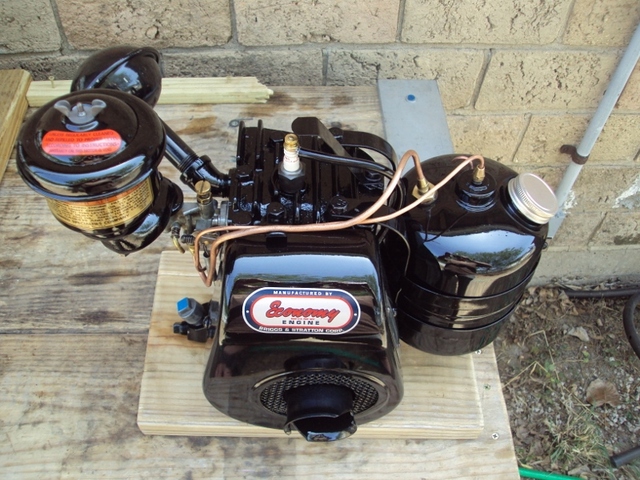

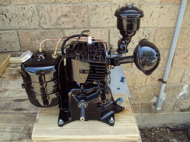

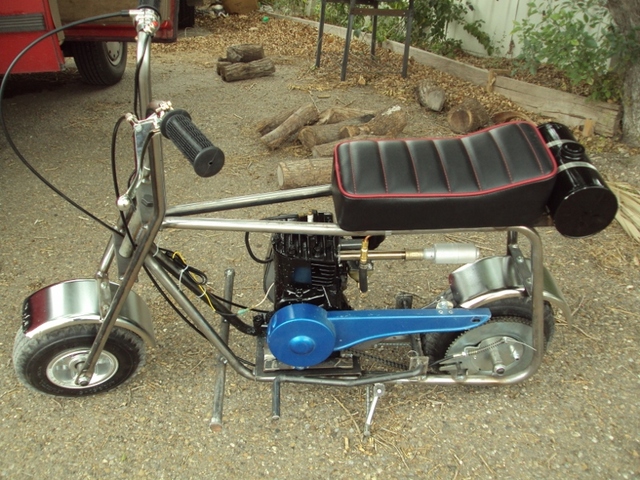

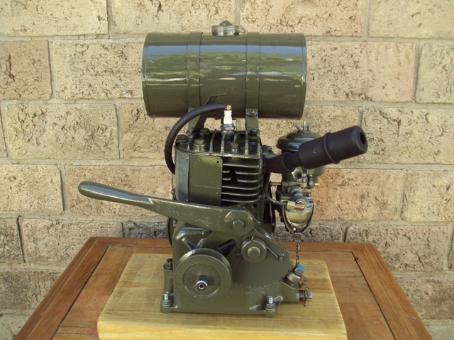

bowtiebutler956 650 #11 Posted May 4, 2013 Here are the pics I couldn't send you in the PM Gerry. Matt 2 Share this post Link to post Share on other sites
