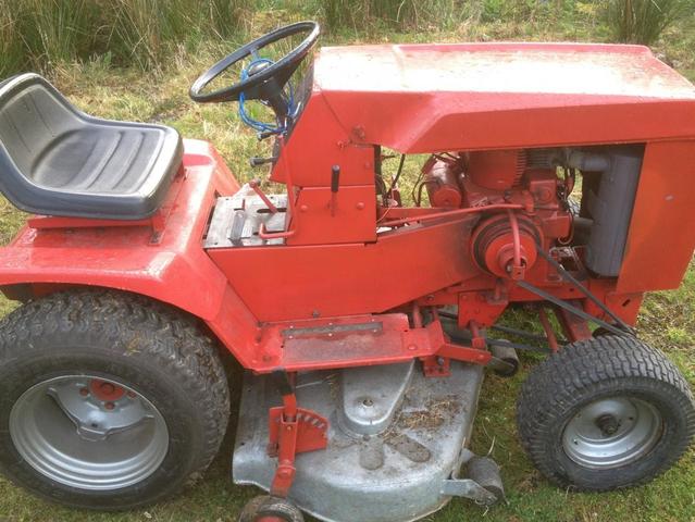

david wheatley 2 #10 Posted April 22, 2013 Having trouble uploading,this is my best effort for time being ! 1 Share this post Link to post Share on other sites

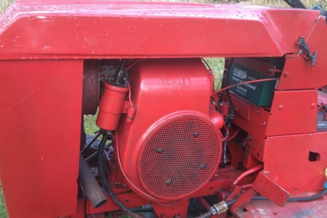

david wheatley 2 #11 Posted April 22, 2013 Here's another! Share this post Link to post Share on other sites
Anglo Traction 761 #12 Posted April 22, 2013 hi David, Firstly Thanks for the Pics, it look's in pretty good shape and repainted, but Yep!, someone's replaced the Engine with one from a different application. The Engine look's like 10/12 or 14hp? solid mount unit. The give away is the External Grass Screen, the Engine shroud wraparound on the Cylinder Fins, not usually seen on UK WHs that I've seen and the standard K series Throttle linkage is missing. Not that any of that is an issue. Assuming you want to know what spec the motor it is, have you got any Numbers on the Engine we can work with?. Regards Share this post Link to post Share on other sites
SousaKerry 503 #13 Posted April 22, 2013 Yep it lost a few ponies along the way, not surprising as the original KT-17 that it was equipped with was a problem child and liked to blow rods through the side of the block when it got mad. Share this post Link to post Share on other sites
Don1977 606 #14 Posted April 22, 2013 Count the head bolts 9 bolts is 10, 12 or 14. the decal is missing or painted over no help there. you could remove the head and measure the cylinder 3 1/4" is a 10 HP, 3 3/8" is a 12 HP, and 3 1/2" is a 14 HP. If you have 10 head bolts it is a 16 HP. Share this post Link to post Share on other sites
Kelly 1,038 #15 Posted April 22, 2013 Looks like they welded up the twin muffler and reused it on the single. Share this post Link to post Share on other sites
